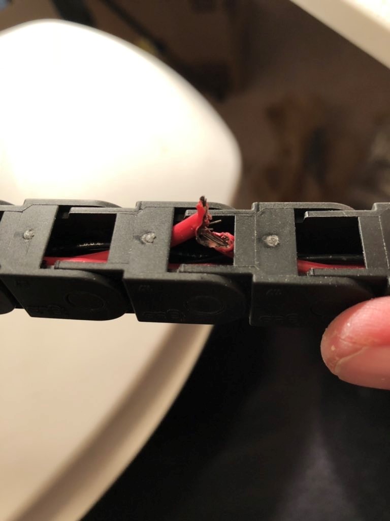

If it’s a mini 1, most likely it’s your heater wire in your cable chain connecting to your heat bed. I’ve replaced it 3 times on my mini 1. The third time I got the mini 2 cable chain and Lulzbot was able to make me a mini 2 cable with Mini 1 connectors on it for a fee. It’s MUCH more robust than the original cable.
It’s stopping the print because the be isn’t heating as the firmware would expect, so for safety it’s shutting the print down. Yeah, the root cause is a bummer, but it’s a easy fix and I, for one, am very happy my printer is smart enough to know to shut down unlike some other printers I’ve seen :slight_smile:
I’ve attached an image of my original cable chain issue.
