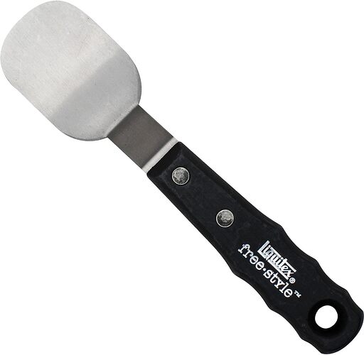

What type of tool(s) are you using? The best is something thin and flat that you can work under the parts – I really like these:
https://www.amazon.com/gp/product/B0027ITF5O
You don’t want any “prying” or “pulling” action. Just something thin and flat against the bed, gradually worked under the part to separate it from the bed. A putty knife will work as well, but it is hard to keep flat against the bed. Be careful if the tool has any sharp corners, as you don’t want to scar the PEI.
You might also try a few drops of 99% isopropyl alcohol around the perimeter of the part. I haven’t tried that myself, but there are posts elsewhere on the forum that say the alcohol will work its way under the part and help it release.
For future prints (at least with that material), add a bit of z offset – like 0.05-0.10mm – so the first layer isn’t squished against the bed as much.
If it is too stuck to pry, dismount the entire bed and stick the assembly in the freezer for a couple hours. This may also result in the PEI separating from the adhesive, which you will need to re-apply, but it will save the PEI sheet in a last ditch effort.
Thanks for the help guys, I got a pallete knife and tried that, but it was tough - in the end I set the bed temp to 70 deg and that seemed to do the job. I’ll be wary to make some features that make removal easier in future though!
