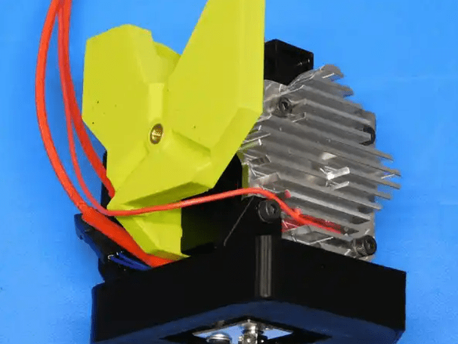

It sounds like the zero sense line on your print head may have been disconnected or damaged, when you removed the plugged nozzle.
The zero sense line should be clearly visible along the bottom of the SE toolhead’s heatbreak heatsink:
When the toolhead starts moving down toward the first washer, use an extra length of wire to contact the washer and the ring terminal that holds the sense wire to the heat sink. If it does not immediately stop moving, turn off the printer to prevent crashing. If it does stop, your connection between the nozzle and sense wire is faulty. Check assembly of the SE toolhead - https://ohai.lulzbot.com/project/lulzbot-mini-2-aerostruder-assembly-and-packaging/hot-end-tool-head-assembly/
If it didn’t stop, now power it back up, and this time use your wire to connect the washer directly to pin #8 of the harness.
If that also fails to stop the movement when it goes for the first washer, it’s either in the bed’s zero sense connection or the board has issues.
