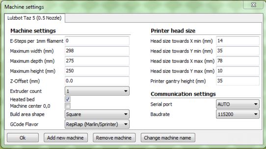

I don’t seem to be able to fine these numbers anywhere…
Anybody got a clue what the correct numbers are?

For which printer? Cura LulzBot edition v15 or newer automatically sets these numbers for the Mini, but not the Taz.
Taz5

I’m asking about print head size in cura. Not nozzle size.

The link to and the published dimensions aren’t enough? Since you own a TAZ why can’t you just measure? It needs that info so when printing more than one object the software knows how much to allow for head movement. So if by default you entered too large a dimension the only harm would be?

I have used sequential printing successfully with the following settings on a stock taz 5. Use at your own risk and keep an eye on the printer. I guarantee nothing.
THANK YOU!

The print head size that I use is:

That is pretty wildy different. Have you added to give yourself a buffer? Seems like a good idea.

My numbers were based on inaccurate measurements and padded based on that lack of precision. I will be giving nopick’s values a try to get some of my build area real estate back.

I put in Nopick’s settings and have a batch print going now. Standby for results.
