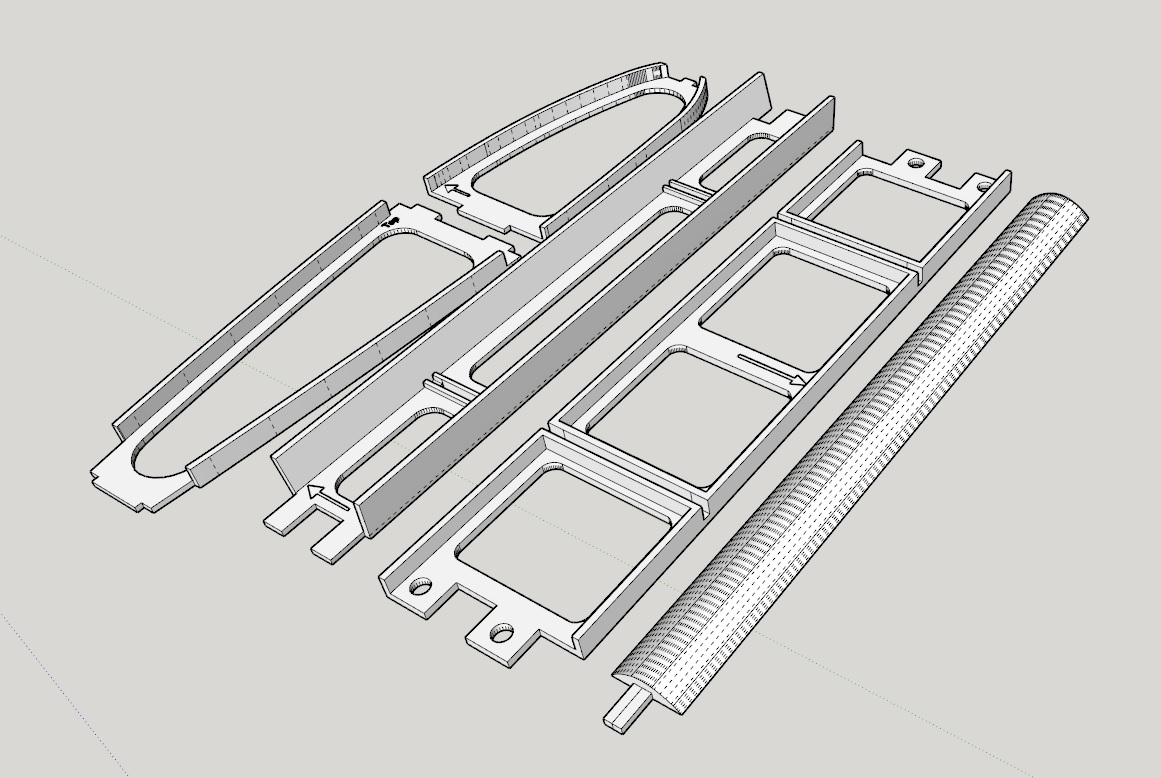

The main wing has just 5 unique parts: Arrayed here for Printing:
Here is an exploded view of the 5 parts showing how they will assemble:
So 7 parts to make a 10 inch section. (two sets of ribs needed) An assembled section:

So the short version of this story is it works. These shots are all of V1. The long version is that if you refer to the exploded view I used tight tolerance tab and slot assembly style here plus many intricate interlocking aspects to make it strong.
I have really struggled with getting the parts to fit. I have experienced a learning curve on parts accuracy issues detailed in other threads (Here: https://forum.lulzbot.com/t/bad-accuracy-of-finished-parts/4315/1 and here: https://forum.lulzbot.com/t/filament-tolerances/4318/1 if you care) So Version two Wing is being drawn now and is going to simplify over all intricacy and move away from tab and slot.

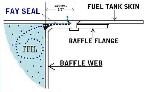

Oh, me and $20 words! It’s just a fancy word for “where parts touch”
I plan to use flanges like this: (but no rivets! :slight_smile: ) Where it says “Fay Seal” make that “Fay Glue”

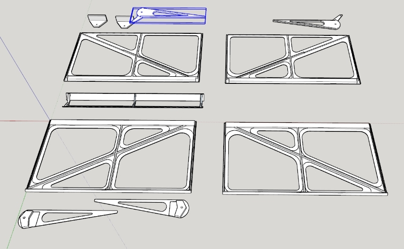

So in the contentious battle of strength to weight ratio I got all crazy in designing the aileron skins which would be significant portion of the strength while having as little weight there as possible. I think I over did but my OCD really loves all the curves! :slight_smile: So first I drew the skins and end pieces:
The skin is 10 inches by 6 inches. I drew this to be a little ‘androgynous’ So here you can see EITHER and left and right set OR I can splice the left and right and make a single 20 X 6 inch aileron.

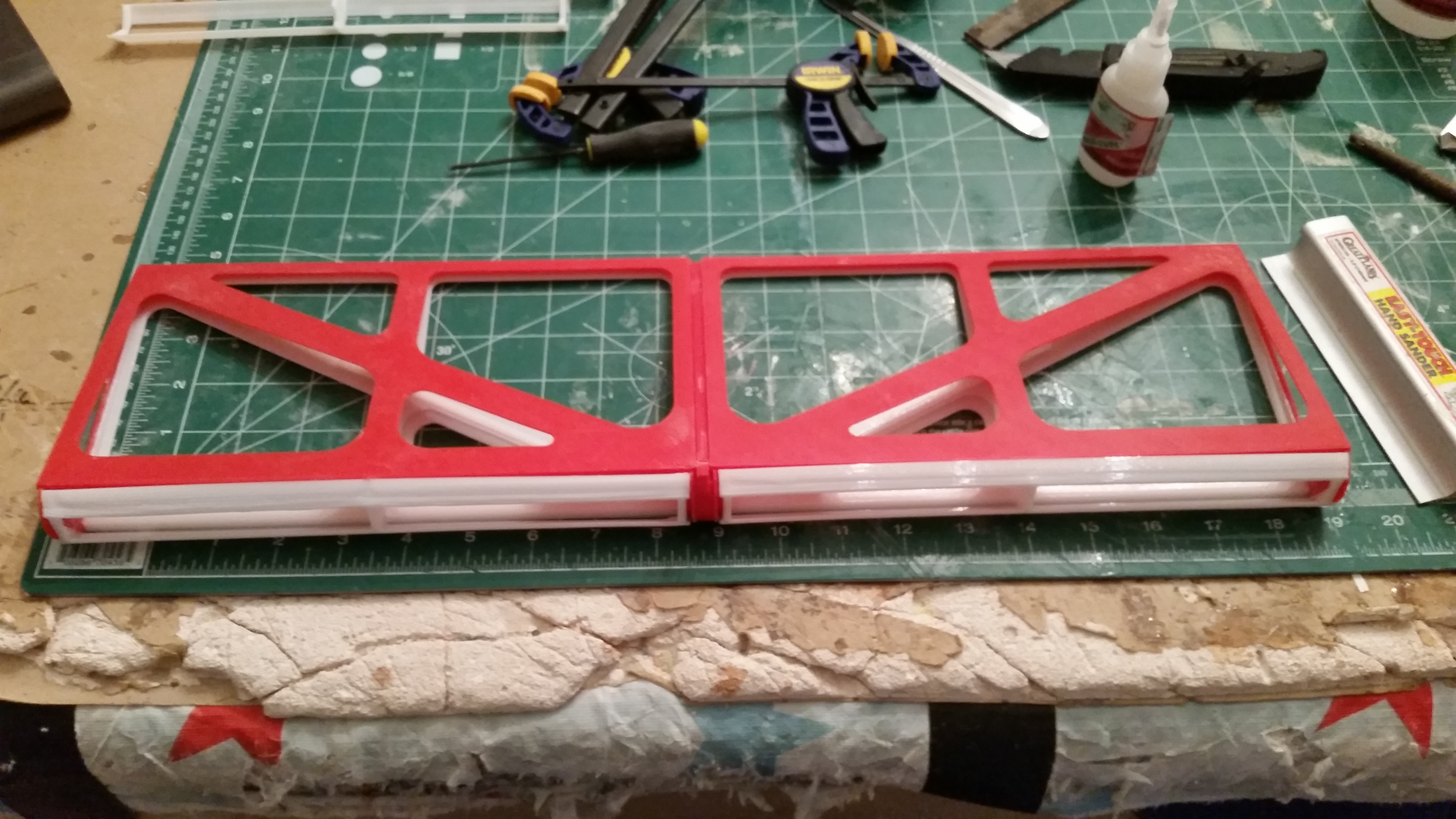

All the aileron parts printed out:
And assembled, it come out at 2.99 ounces for a 10x6 inch piece. I am pretty happy with this number!

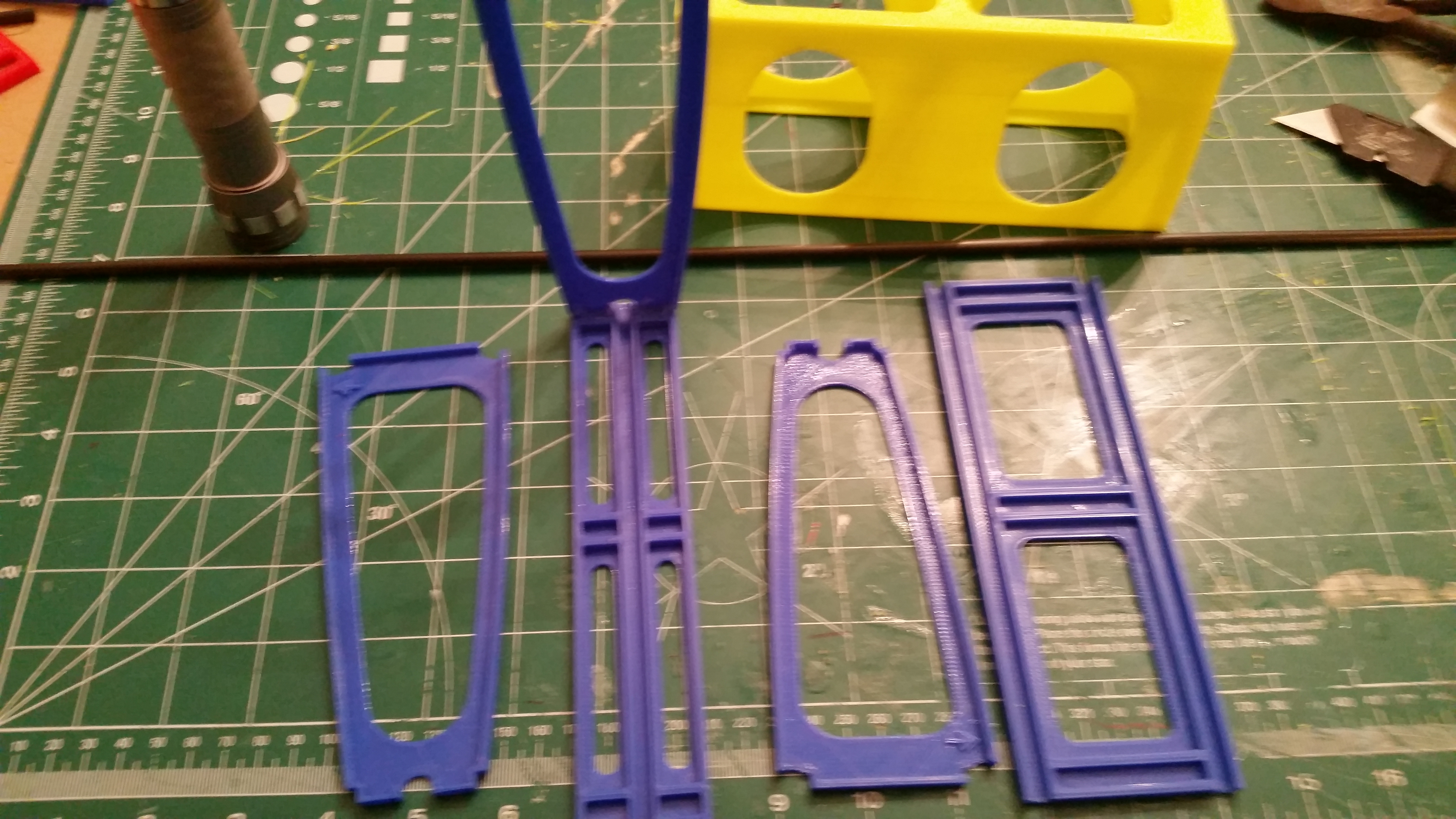

Here are all the distinct parts that will make up the wing. Not many distinct parts but the parts on the right will repeat many times!

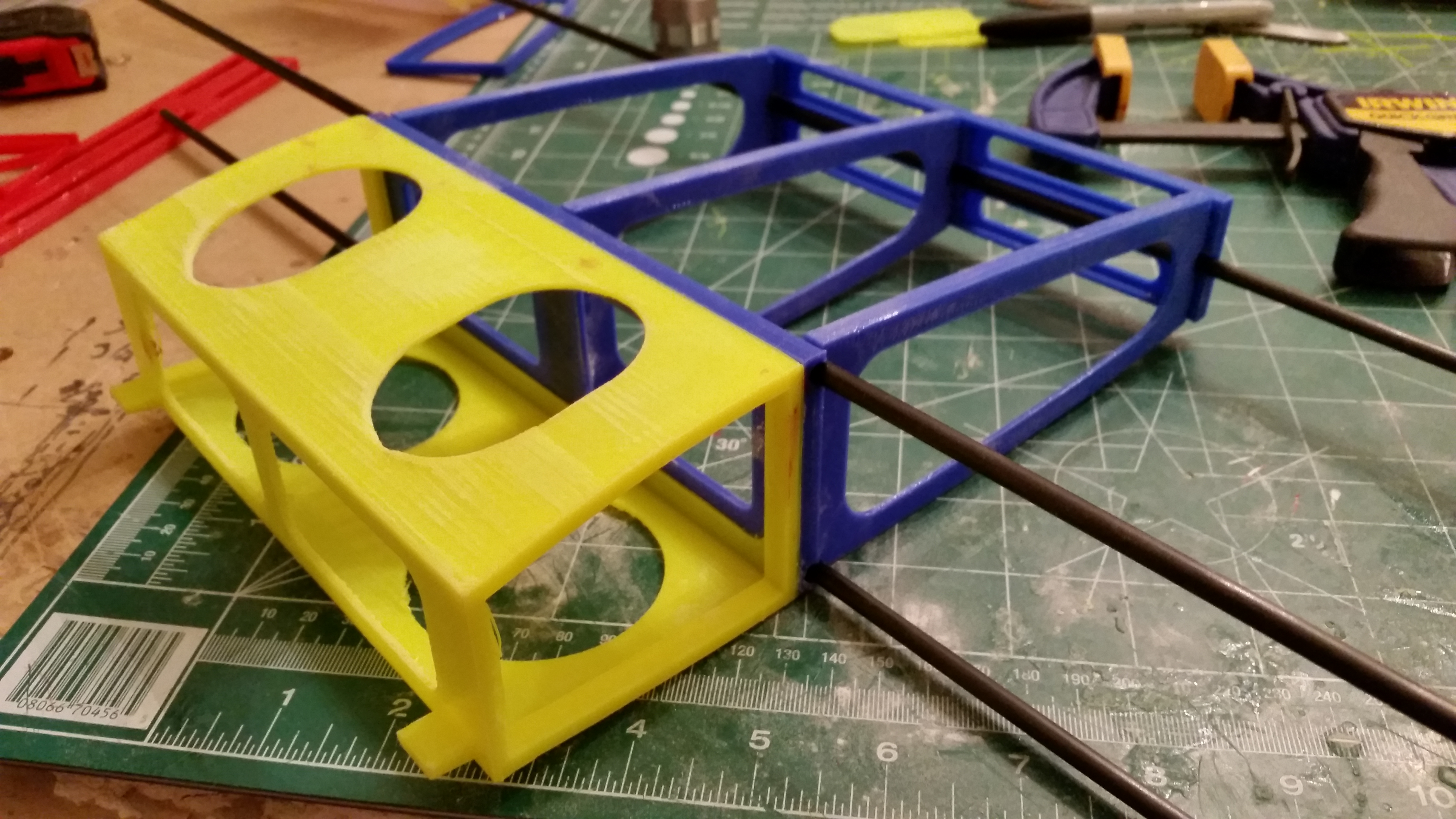

We are concentrating on the center wing tonight. It is the toughest part strength wise and print wise as it will be the where the wing and body tie together…

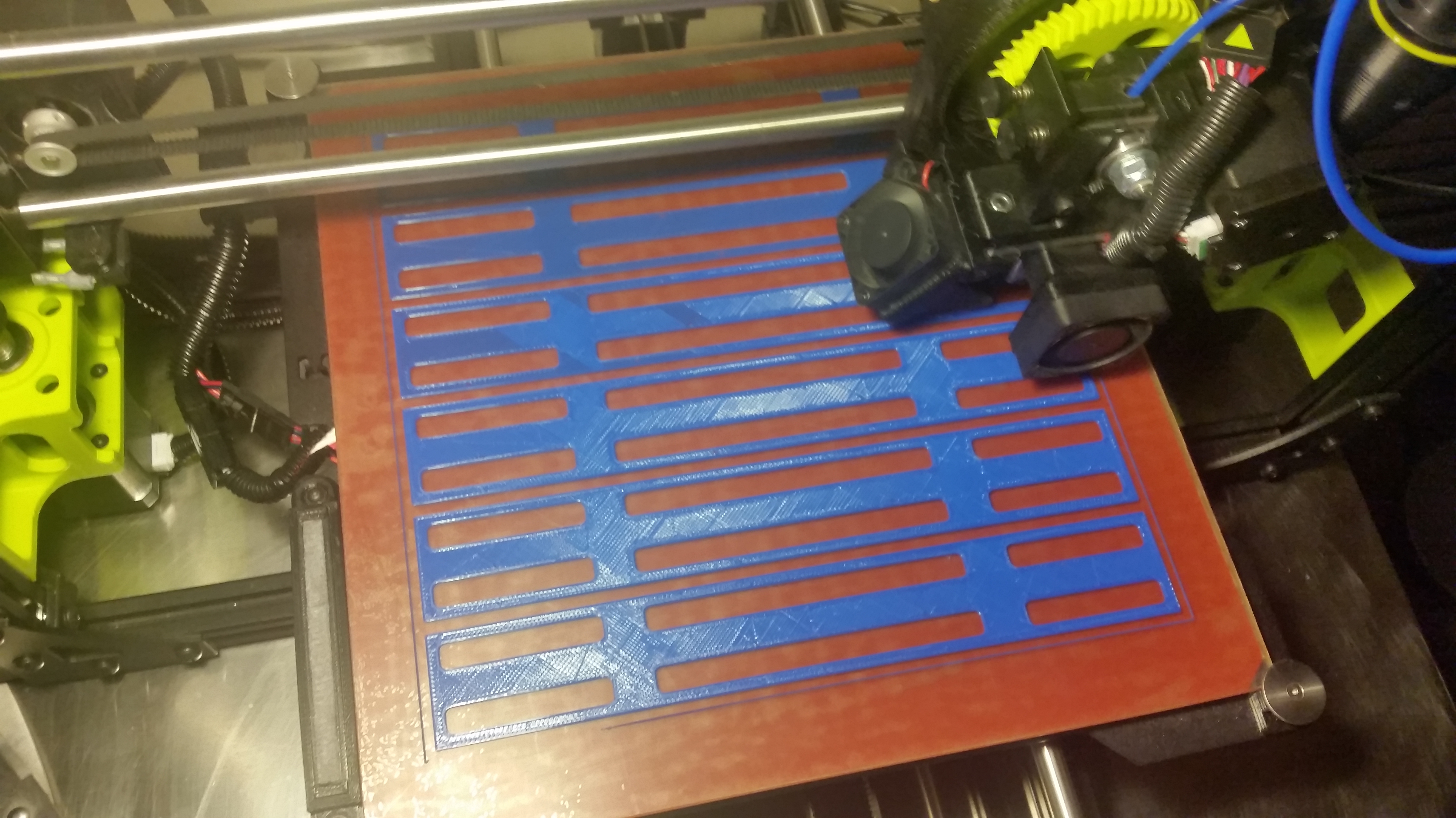

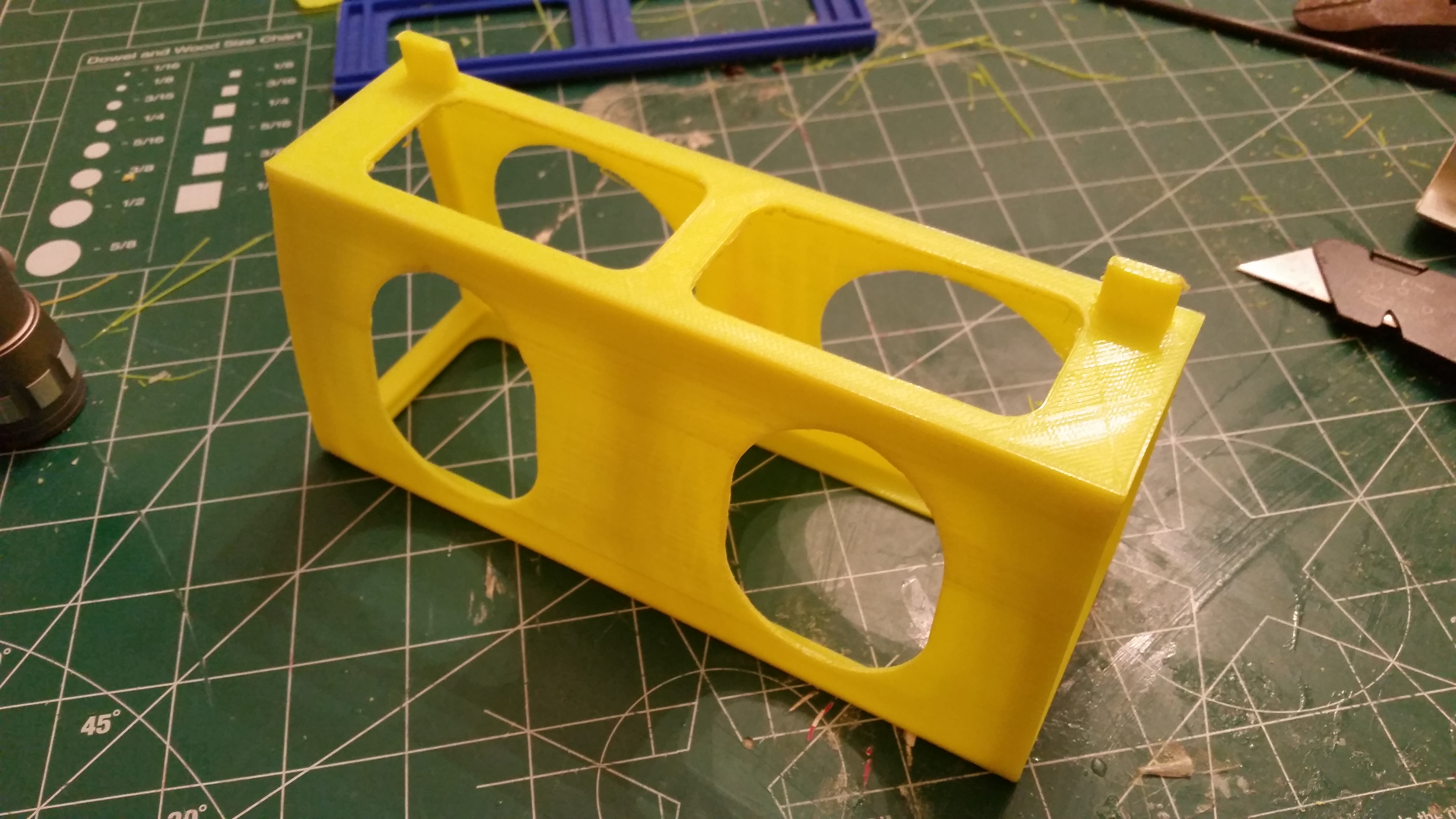

This is the Center wing Leading edge. For me, this was the trickiest print I have done to date as every single side is open. I printed a single layer under the top lightening holes then I cut that single layer out with an exacto blade. It has to be tough as all wing forces will concentrate here. Note the mounting lugs.
Here is everything needed to assemble the center wing section printed out;
The three ribs and two spars glued together
Then the leading edge glued to the main spar. The Carbon Fiber rods are not glued into their grooves yet. They are just for show at this point. but they are coming and will be key!

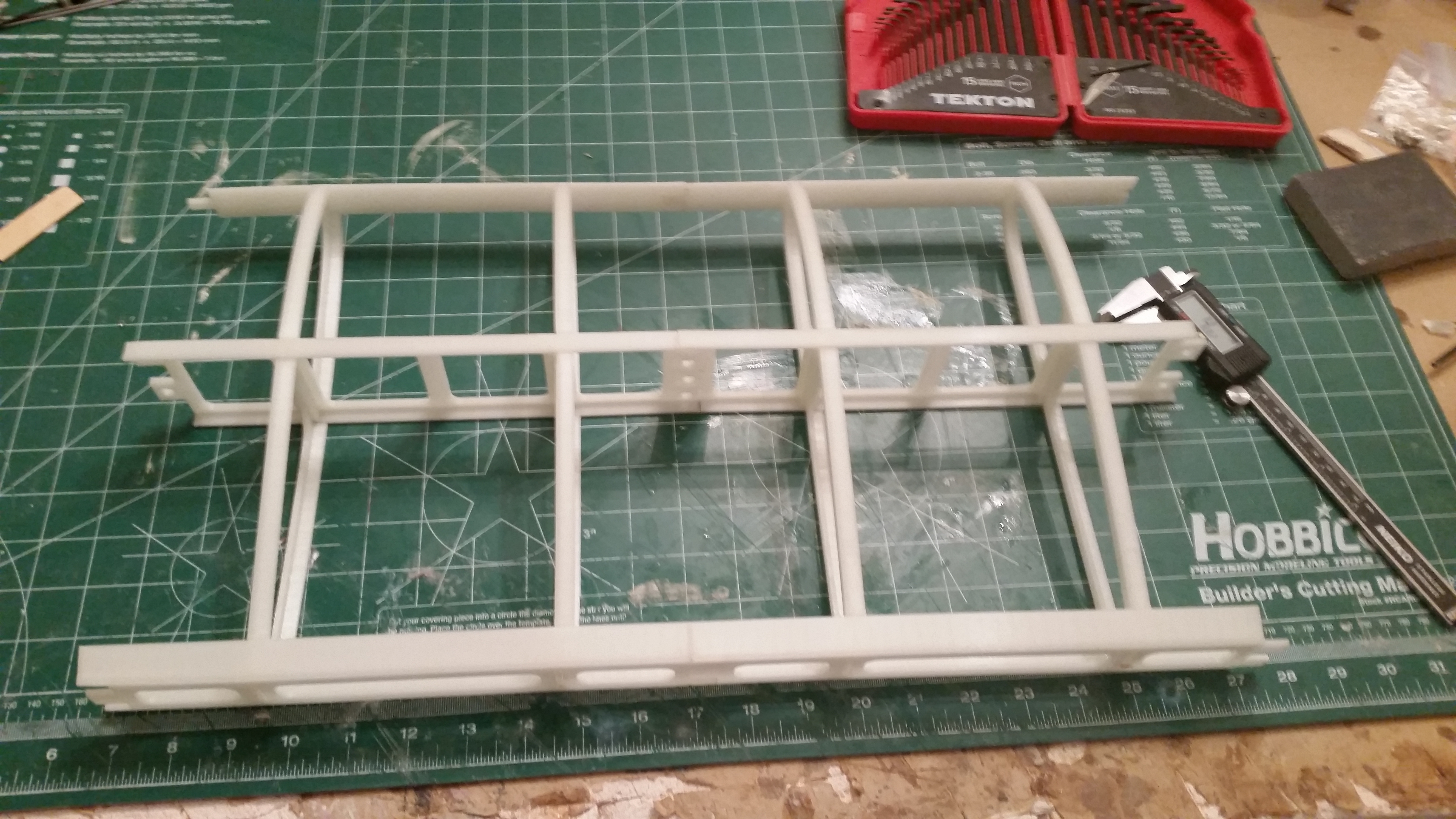

So here is the heavy lifting- main wing assembly! There is LOT printing that went on here, check out that pile of parts! :slight_smile:
First I put the main and trailing edge spars together with the 5 mm carbon fibre rods I purchased. Then I started putting the back ribs into trailing edge spar… You can see both spars with the CF rods here and the beginning of the ribs…
Then I snapped the other end of the ribs into the main spar then glued them. So here is the center third of the wing…
It was getting late so I did not get to do the front third yet So there is still a good bit of that pile of parts left! : ) Here is the back two thirds of a 68 inch span wing though
