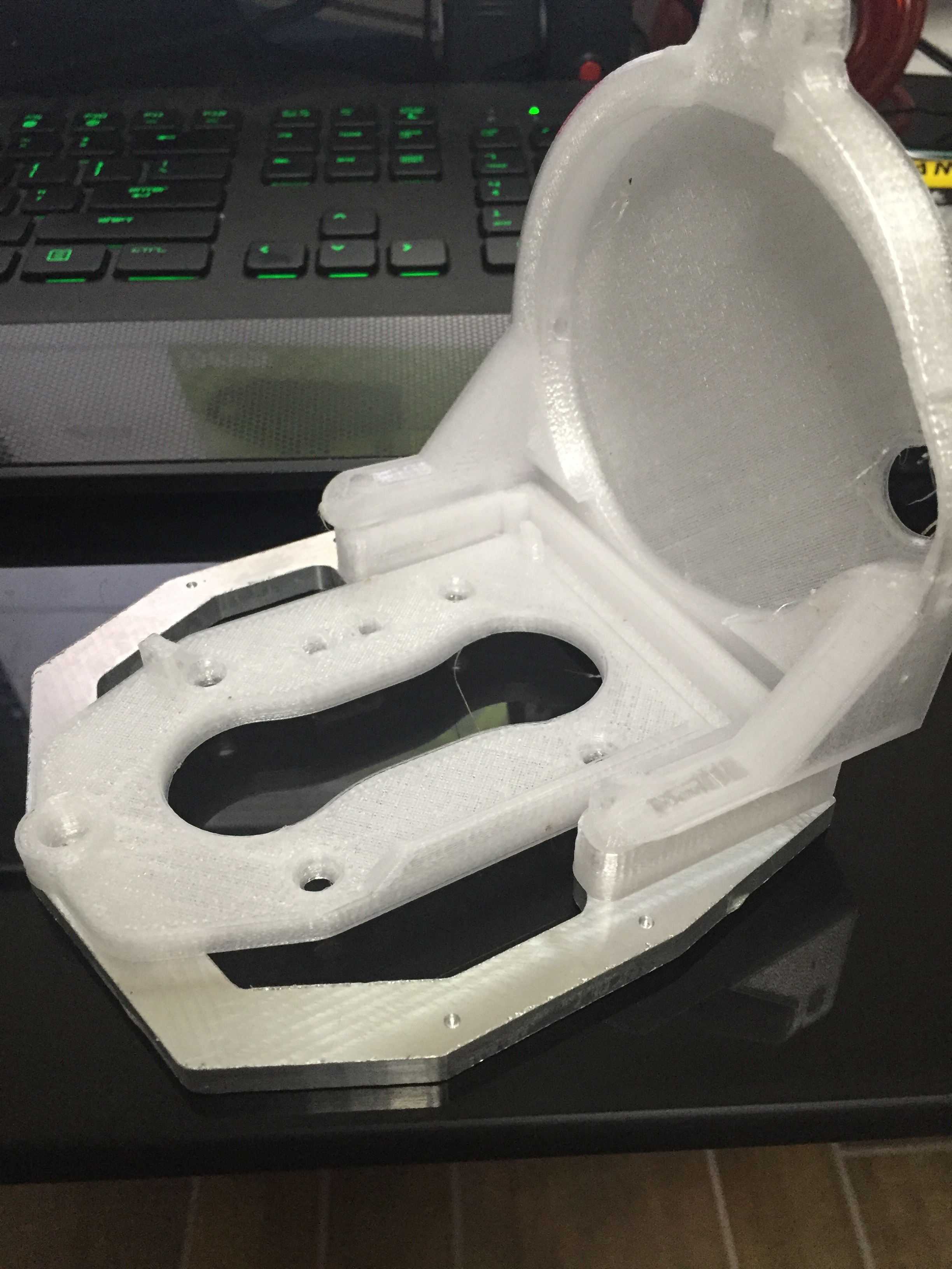

It’s the dual hexagon extruder. I tried to start by milling out the bottom bracket that is made of aluminum but failed with the workpiece worked its way loose from the clamps :frowning: I might be able to salvage with some manual cutting. Will attempt tomorrow and post pictures

Attempting again since I messed up my first one. Turned my feed rates way down and smaller layers
Here’s the cut-out one. Need to finish the holes on my drill press though
Nice!
Got the holes put in. Whoops, looks like there are more parts that I need to machine…
Looking great!

Fighting some major backlash issues on my X2 converted CNC. It aint pretty but after some filing and sanding, the hexagons fit
That looks great! That center circle on the plate has always intrigued me… could be a nice spot for a capacitance sensor. Is it greater than 12mm?
The circle is a diameter of 16. I ran the hotend cables through it.
I re-installed it on, and while using only one hotend, it’s printing good. It’s beefed up quite a bit in weight but it doesn’t seem to be a problem. Piercet’s openrail is holding up great with no noticeable flex in the X axis.
