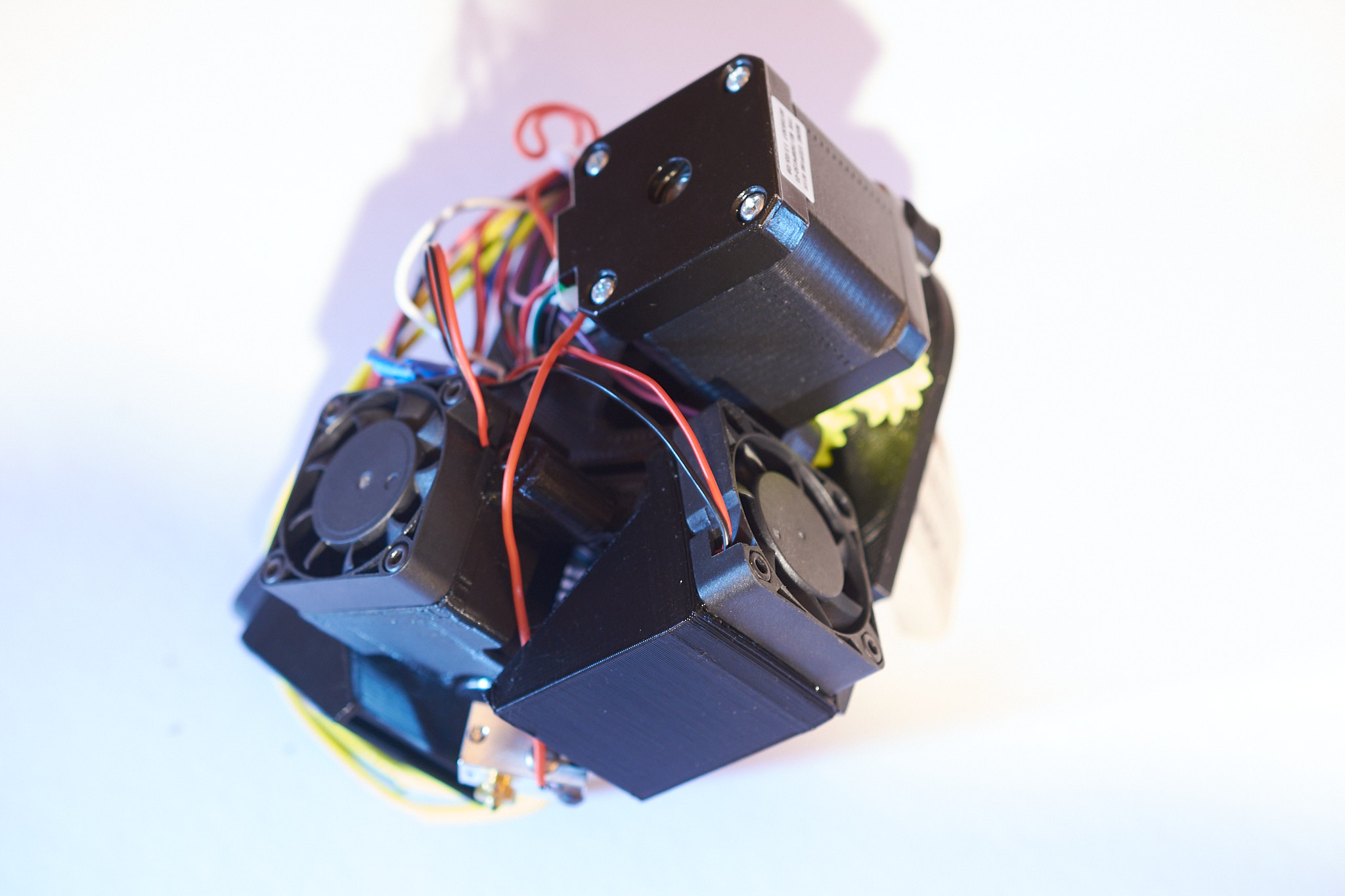

Good news, I managed to create some decent parts for the conversion process. I have a custom hotend mount, heatsink fan duct for the E3D V6 hot-end and I managed to create some fan ducts (not thrilled with the design) for the 24v dual fans on the sides. I have wired everything together and now in the process of fine-tuning the firmware. Everything I am doing is meant to be plugin and play with the TAZ 6. If anyone is interest on the some documentation, let me know and I’ll continue writing my progress as I go. If not, I’ll shut up and keep trucking.

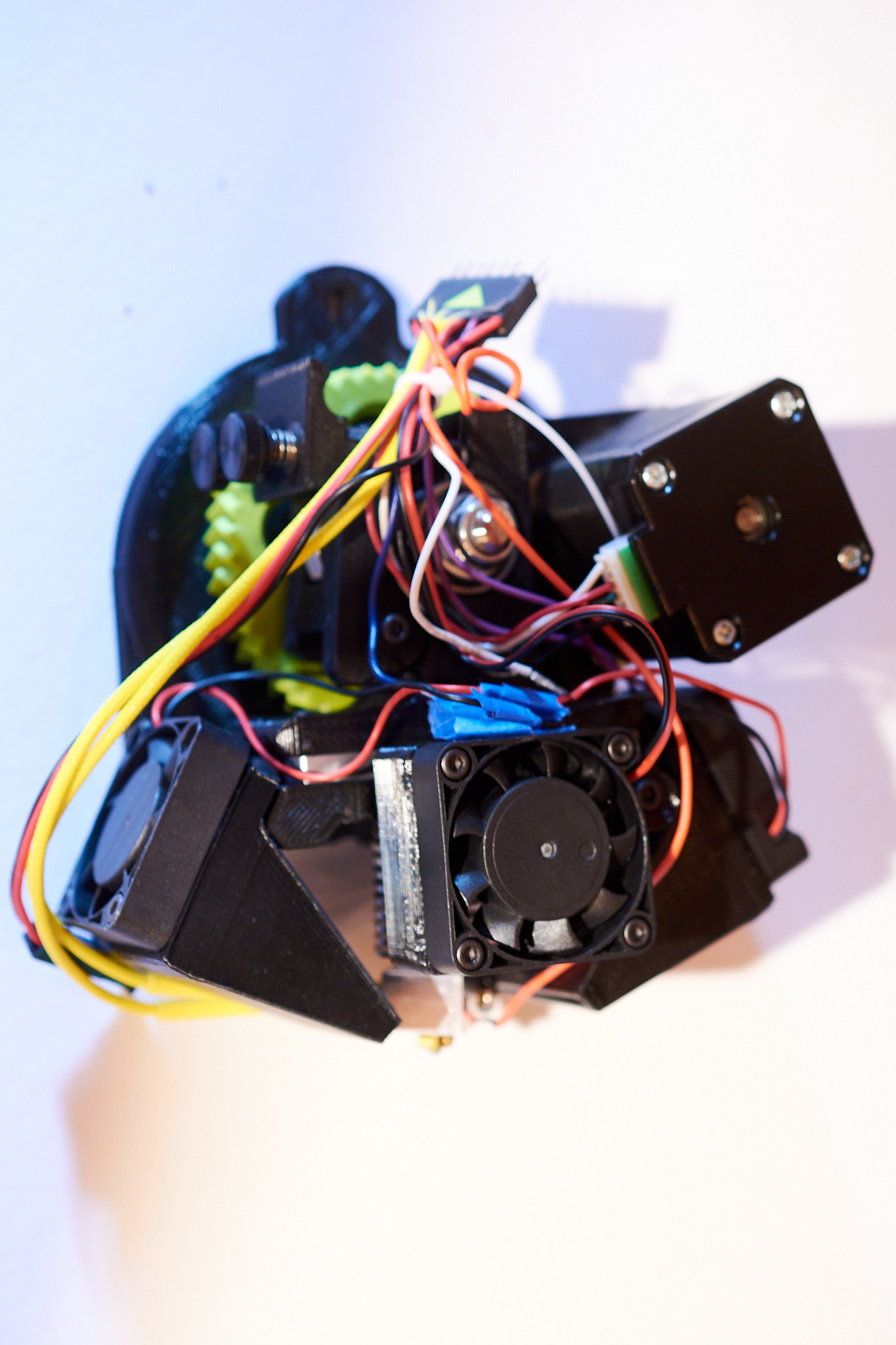

I’ve been reminded this week how many shortcomings this printer originally had when its just the original single extruder set up. I am excited to jump into a new era of lulzbot print heads when I have more dough, I also love the look of the Hemera upgrade. This is a daring project to connect quality hot ends with Taz.
Sorry for the rat nest of cables, still sort of in the prototype phase.
This answers so many questions I have thank you. I’m still curious how you bypass the signal wire, or did you attach it to the new ed3 heat block? Did you tap the new block? I’ll look into your wiki again to dig deeper.
You do not need to do any modifications to the heat block. I attached the z-probe directly to the block. The block has a washer that tightens the heat cartridge between two separated portions of the block, I just replaced the washer for the z-probe wire.
