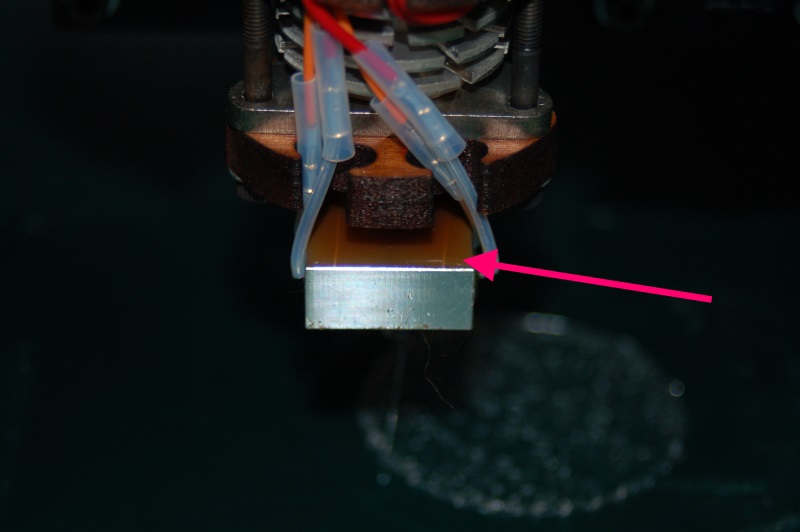

For instance the attachment is done at 90% and solid infill
