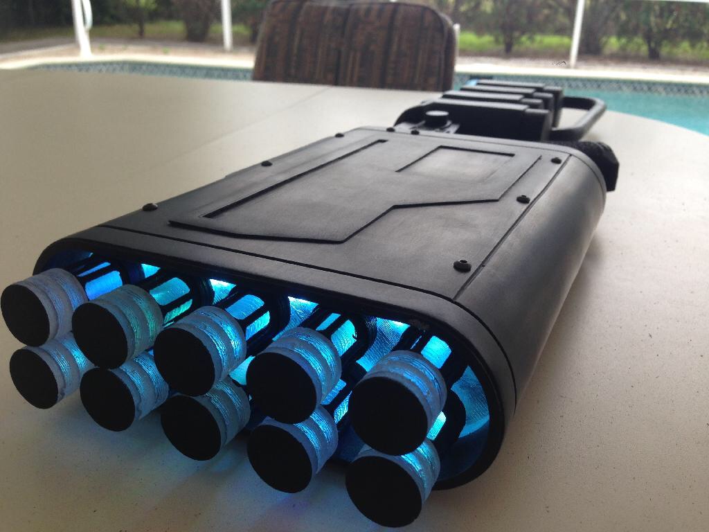

If you ever run into a Batman with a nice EMP Gun at one of the conventions, I made a few with my 101 and TAZ. Only the handle is not printed. :mrgreen:
Very nice indeed!
