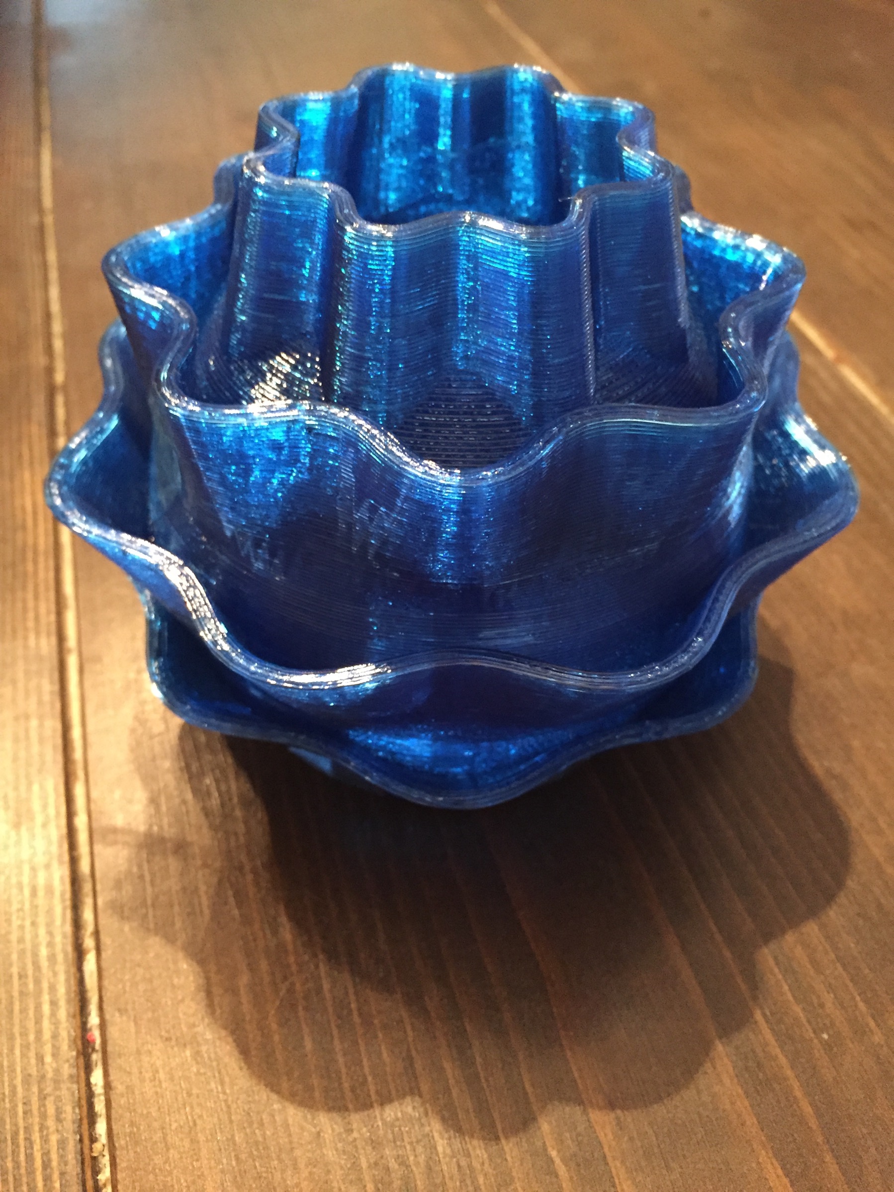

I print at 245C extruder temperature. I use a clean PEI bed at 60C for small prints. I use a thin PVA coating at 45C for items with moderate contact area with the bed (75mm diameter or more), hoping to make removal of the part easier.
Here is a photo of a blue T-Glase flower, 245C extruder, 500um layer height:
Wow very nice. I will give 245 a try today.
