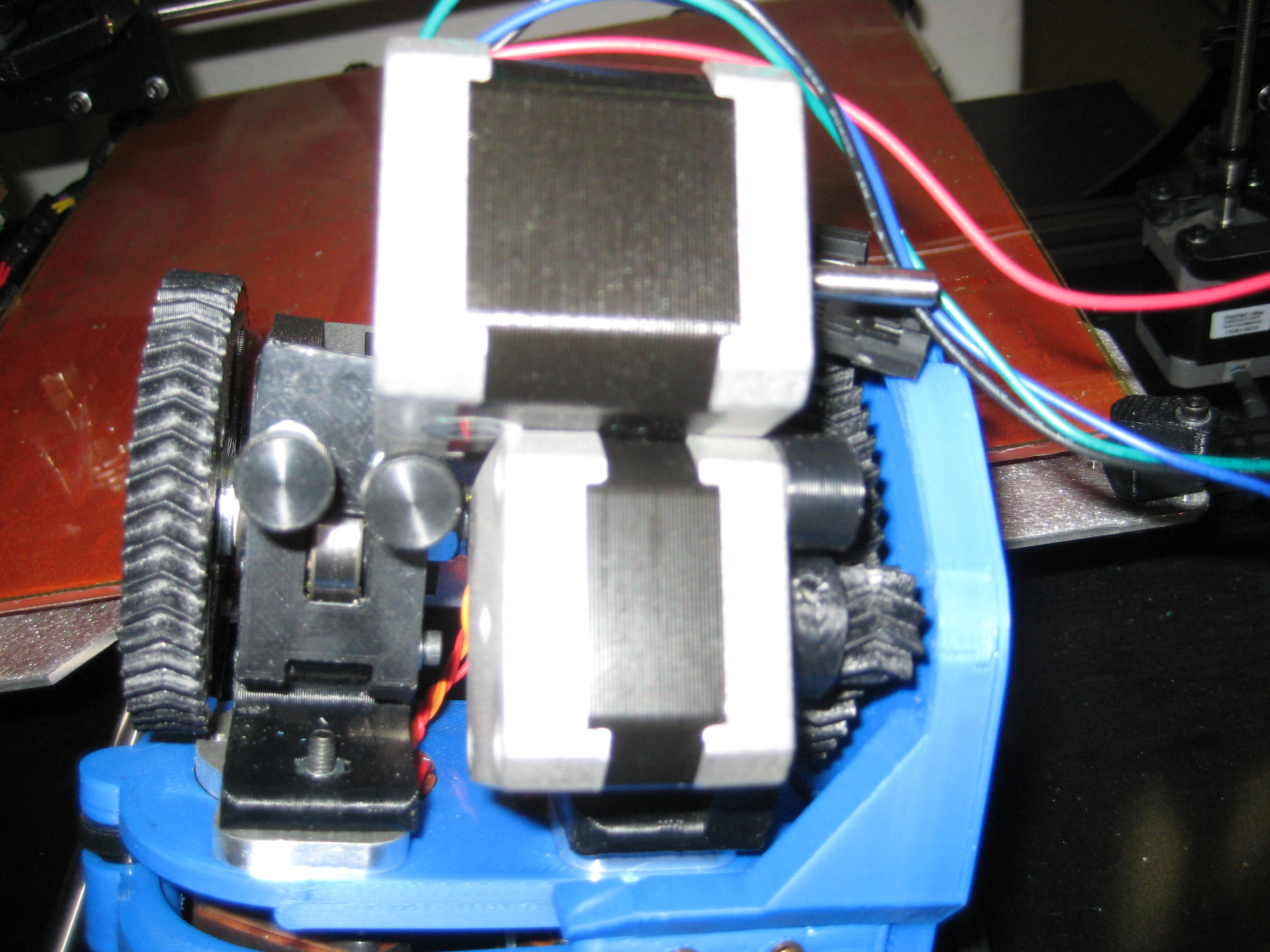

How important is it that we use the Half Height Motors (42BYGH001-D) ?
I tried to buy some from Kysan (minimum order of $100) and they only have 1 in stock (in China).

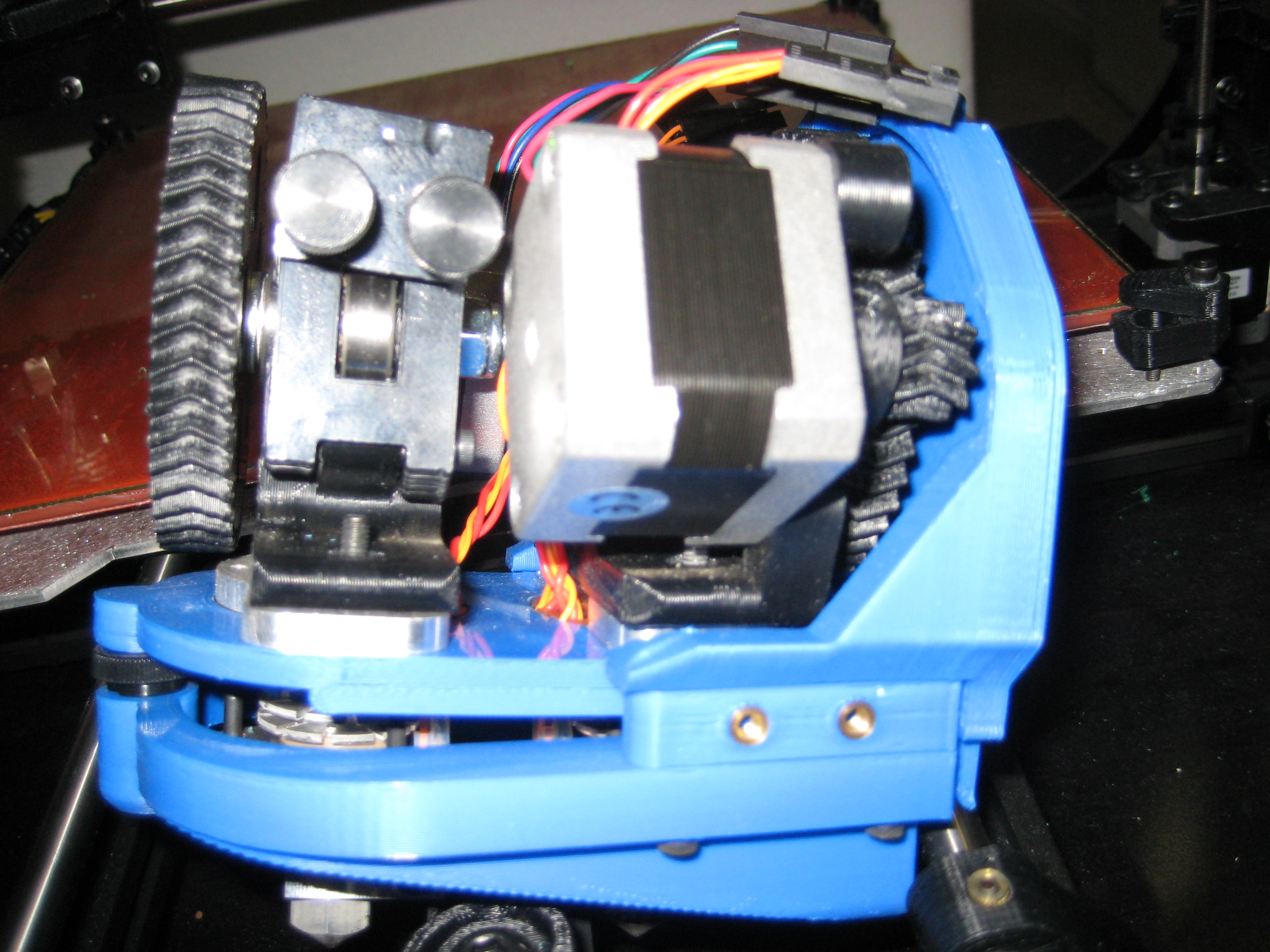

For the Official dual extruder design, very important. Standard length motors won’t fit. Here are some pictures of the Lulzbot Dual extruder. I’m not 100% certain this is identical to the final production model, and I’m not sure I’m at liberty to disclose it’s source, but lets just leave it at “I didn’t print this one”. You can see that the half height motors clear the second extruder, and the full length motor sitting on top won’t. I’ve been playing around with one of the extruders just in single configuration to see how well it holds up, and the motor has plenty of torque and horsepower. As soon as i finish the Taz 4 end upgrade and get the lighting subsystem mounted I’ll have this guy on the machine and turning out some neat things. I ordered the wrong bearings for my 4 ends though, so thats been a bit on hold. I’m getting caught up though finally. Anyways, heres some pictures of it.

I was able to use the normal NEMA 17 stepper motors, sourced from LulzBot.com on my dual extruder. It works, but it is rather tight. It takes a bit of wiggling and moving things into place. Given an option, I’d go for the half-height stepper motors just to make things easier in the future to swap out the extruders on the dually extruder mount.
There’s a possibility that the spare motor I have is taller than normal too. I didn’t check it against anything.
