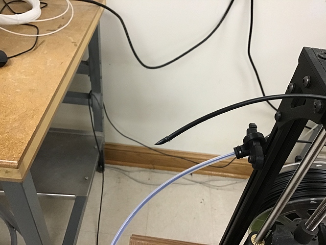

As soon as the print extrusion begins, the ABS curls back onto the nozzle as soon as it is squirted out. See videos.
Start of print
hand fed curl
I pushed filament through by hand at various nozzle temps: same result.
The nozzle is about 4 days old with perhaps 8 hours of heated time.
I did a cold pull. Maybe interior of nozzle is asymmetric/slightly clogged? See pics
I use eSun cleaning filament when my nozzle “gets the curls” and one or two cold pulls usually cures it.
What temp to you run it up to and when to pull it out?
The cleaning filament has a very wide temperature range. Use the temperature of the filament you are cleaning out (i.e. PLA 190-220, ABS 240-260, etc.). Extrude filament until there’s there’s no visible residue. Then cool things down and do the cold pull. If that comes out clean, you are done, if not, heat things up and go again.
I do cold pulls at 100-120. Experiment with the cold pull temperature until you get a good imprint of the inside of the nozzle. On my TAZ 6 Single Extruders, I can shine a light into the top of the tool head and see (with the help of a mirror) a nice round spot of light through the nozzle.
ABS is one of the most temperature sensitive filaments out there. I’m not surprised that as soon as hot ABS strings hit cold air, it curls.
ABS needs to be printed in an enclosure with an ambient temperature around the printer to be rather warm.
If you have some PLA try your “curl test” with that.
I’m guessing you’re just seeing what ABS does naturally.
ABS contracts like crazy when it cools. A thin string is going to curl when it cools.
Just my 2 cents.
Yes, edlink is right.
After some cleaning and cold pulls I put a reel of PLA in and it seems to be extruding correctly without curls.
I thought all was well until the test piece began to warp and lift off the bed.
z offset is -1.35 right now.
i want to make a primitive enclosure and see how that changes things.
