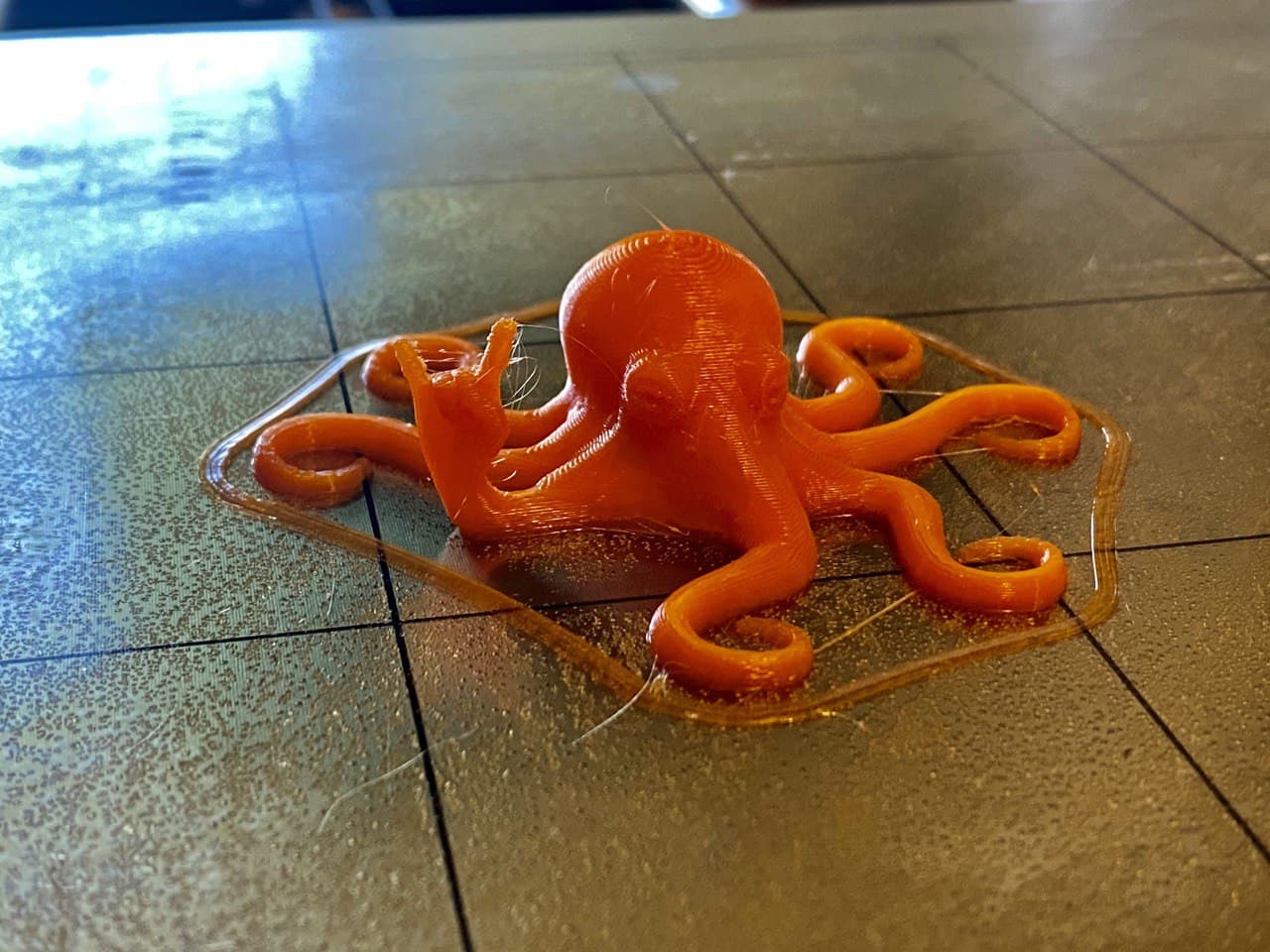

Well, I bought and installed the stock M175 print head and replaced the four TPU corner supports. I updated the firmware to 2.0.0.144.1 and, before printing the rocktopus in the latest Cura (3.6.23) checked the x-axis and bed level-ness.
X-Axis was raised to maximum Z. I measured the distance from the top of the frame (above the plastic Z caps) to the top of the smooth rods with my Mitutoyo 500-196 and turned the lead screws until they were 34.45±0.05mm on the left and right.
I homed the X,Y, and Z then sent the “G29 V4” command.

I can put shims under the corners again, but I thought replacing the print head might also fix this issue in addition to the corner mashing. It is a really obnoxious problem. The bed correction has the highest efficacy when the corners are within ±0.25mm of the 0 point.
Any ideas? In the meanwhile, I’m going to apply layers of copper tape between the Y-axis and TPU corners (and the spacers).
This will do.

Zero Tuning besides the Bed and X-Axis - I call this a success.
