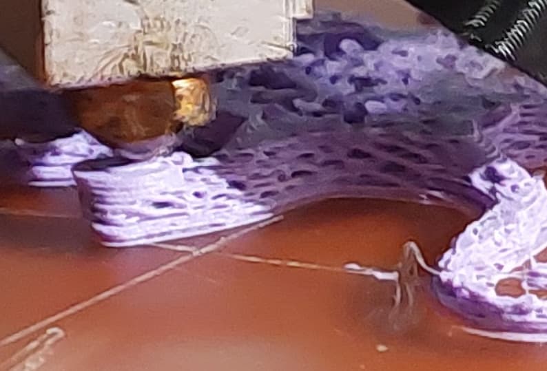

That looks normal! That’s what baffles me about all of this, is that parts of it work that you wouldn’t expect to work. The things that don’t fail are the things we’d normally look at when a printer isn’t behaving correctly. And the things that do fail almost feel like they have no rhyme or reason to their failure, unless it’s a needlessly complex problem or a super simple one that we’re overlooking.

I’m nearing my wit’s end… not saying I’m giving up, but man this machine is driving me nuts. I’m close to just taking a video of it and seeing if anything can possibly be diagnosed from that.
That doesn’t look like the extrusion of a 0.5 nozzle. Looks like 0.8 or larger. Me thinks you have it set to 0.5 and that explains the squished layers and under extrusion.
This is what a 0.5 nozzle extrusion looks like. I tried to recreate your picture using my incredibly bad photo skills.
Well. Could it have been this whole time, most of my problems have been caused from the nozzle not being stock?
I guess it’s possible.
Well, good news, I guess: in my wake of frustration and haste, I managed to bust off the screw part of the nozzle inside of the heat block, so I ordered a new nozzle and a reverse/inverted screw to get the remainder of my destruction out of there.
Well, I appreciate the reply. If this fixes it, I will be infinitely grateful (and probably infinitely smacking myself in the head for not thinking about this earlier).
The nozzle is stock, but, that’s not a Single Extruder.
That’s a MOARSTRUDER.
That explains a lot.
Trying to extrude .5mm worth of filament out of a 1mm hole isn’t enough to have a contiguous bead of plastic, and it just goes wherever there’s less resistance instead of lightly squishing onto the previous layer.
