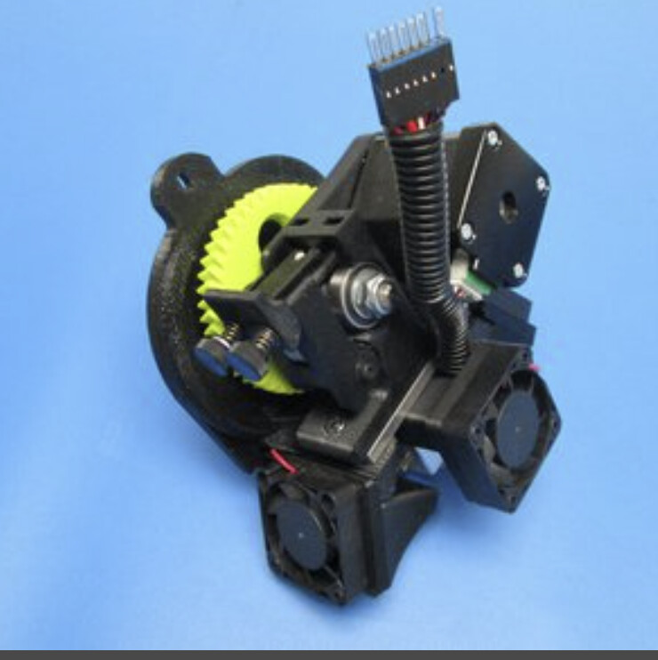

Taz SE? That’s not a model of lulzbot. Is it a Taz 6 with the SE toolhead? There’s some confusion with toolheads. There’s the Single Extruder:
That came as the standard toolhead on the Taz 6.

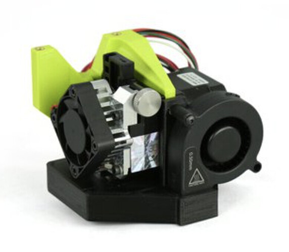

There’s also the SE 0.5mm toolhead:
Which could be purchased and was based on the e3d Titan Aero.
If you are running older firmware for the Single Extruder with an SE toolhead, the offset for the nozzle will be different. If you are running the universal firmware and have the wrong toolhead selected, the offset for the nozzle will be off.
