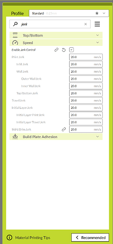

I recently updated my Cura-LE to 4.13 and I am noticing the printer has become extremely “jerky” during prints. The jerking is so bad that when the prints get to roughly 75mm, the prints seem to shift and there is no way to print a straight column. Some of the jerking is so violent that the prints shake loose from the print bed. Attached is an image of a recent column print, actually a Cirkul pod holder that is erroneously bulging near the top.
Is there a way to reduce the sudden movements by both the bed and printhead? I realize there is a desire to reduce print times, but at the expense of quality, such reductions in time are meaningless if the print is not usable.
You can try reverting to the previous version of Cura, and see if the behavior changes. If it does go back to acceptable, compare the jerk settings between the profiles:
