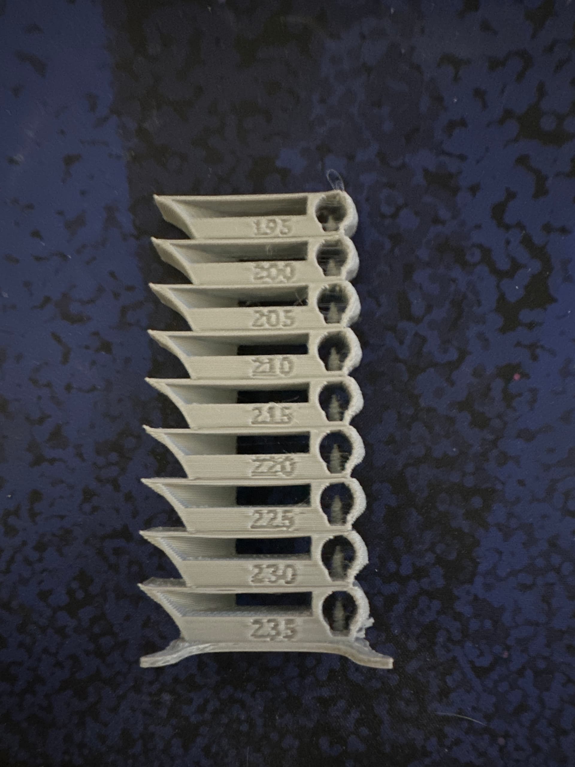

I finally printed one of these after @TheVirtualTim and @b-morgan have been after me to do since I got my used printer in March. If I post a picture would one of you two gurus be willing to give feedback on things I should be looking at? I’m also concerned the glass bed on my printer is being flexed or warped because of something I am seeing when printing.
Regarding the glass bed (so I am assuming you are printing on the “glass” side and not on the matte-finish PEI side … you can flip the bed plate over depending on what type of surface you need) … what type of filament are you printing (PLA, PETG, etc.) and are you using an adhesive/release-agent on the bed (such as PVA (e.g. Elmer’s glue-stick is PVA)?

The bed is not reversible it’s a Taz Workhorse and the heating element is attached to the glass. I replaced the PEI because it came without it and I couldn’t get PLA to stick without massive rafts previously.
Hmm… it seems there may have been some modification of your printer.
The normal bed on a TAZ Workhorse is reversable. The glass plate has a PEI sheet bonded to one side but is glass on the other side. When I print PLA I use the PEI side. When I print PETG or TPU I use the glass side but use either Magigoo or Elmer’s glue-stick (PVA) for adhesion of PETG – and nothing (just clean glass) for TPU.
This plate is resting on the bed heater with the foil layer that has the 1cm grid lines (visible through the glass). You should be able to remove the four corner-washers and you can flip the glass to print on either the glass side or PEI side. If this is not what you have, then I’m wondering what may have been done to your printer prior to you owning it (it would not have come from Lulzbot with the bed heater attached to the glass).
PEI sticks better on the “matte” side (vs. the glossy side). Skin oils (fingerprints) will reduce how well parts “stick”. While Isopropyl Alcohol (IPA) cleans the bed, it doesn’t necessarily remove skin oils (it tends to move them around). You can clean the bed with a mild solution of Dawn dish soap, clean thoroughly to remove oils, then use IPA to clean any residue and wipe clean with a paper towel. From time to time, you can re-rough-up the surface of the PEI with some sandpaper … maybe 450 grit … just gently to help PEI stick.
This is what I have.
The temperature tower was printed on a 15c offset (250 bottom layer). The nozzle is the .5 hardened steel. The printer was purchased second hand off eBay and I have no information about what may have been done with it before I got it. The printer did come with an octograb plate but no magnetic thing.
