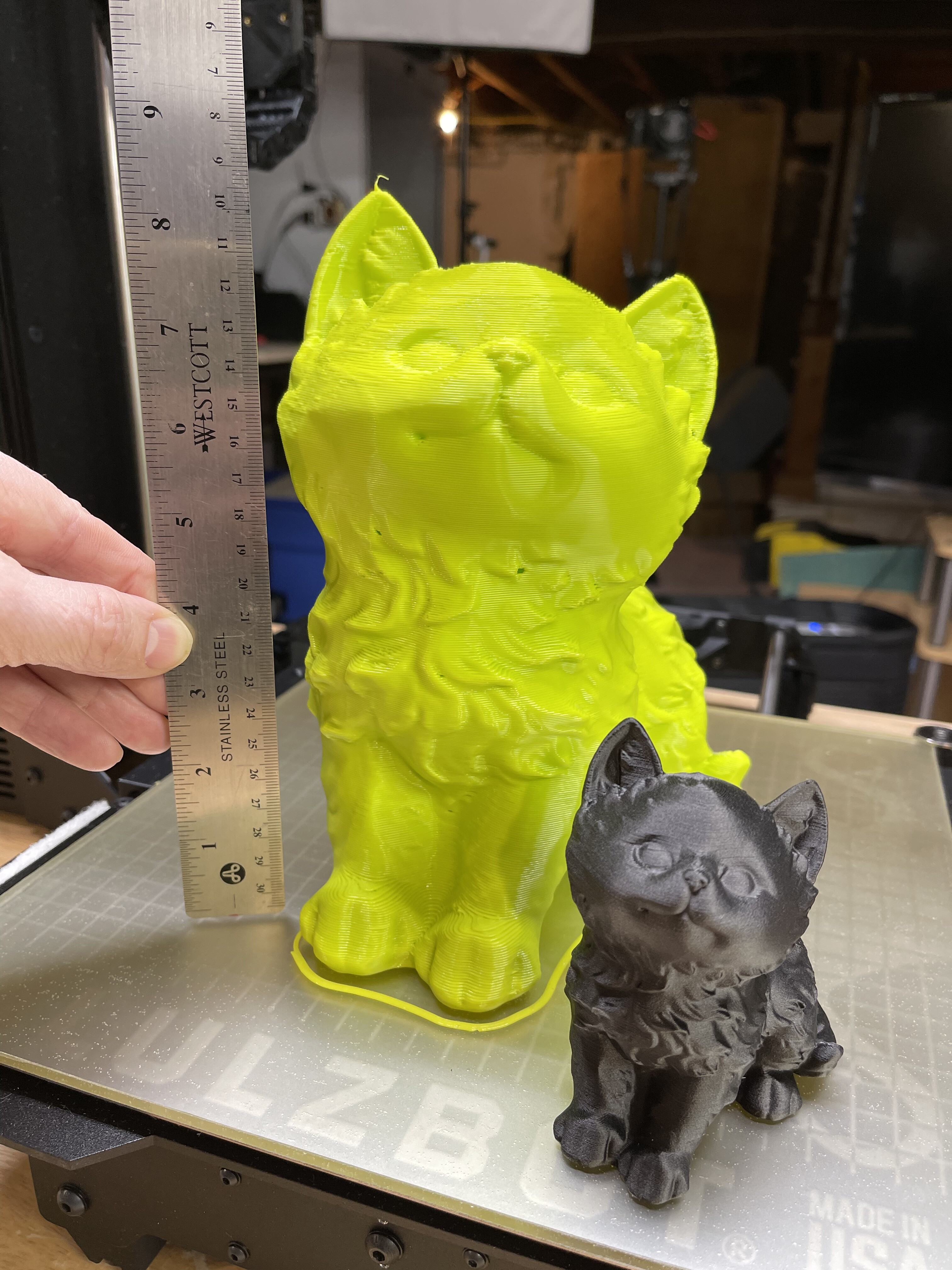

I got creative after dialing in the flow settings
Not pushing the expanded dimensions yet, keep going!

A 1.2mm nozzle is a pretty fat bead, so I am finding that if your model has a lot of details, this isn’t the ideal beadwidth. I have a lot of experience printing with large nozzles at work. For the hobbyist and pro-user, I’m not sure 1.2mm is the right size. For most of my large prints, I use 0.8 so I can maintain a 0.25 layer height, keeping the model’s details while printing a lot less perimeters. Prints that require support fare a bit better. I printed a part from my Iron Man build last night and it was impressive to see. It took my other machine, with a 0.8 nozzle about 36 hours to print and this XL did it in 8. But, some of the finer details did suffer. I think I can save it with putty and sanding during the post processing.
