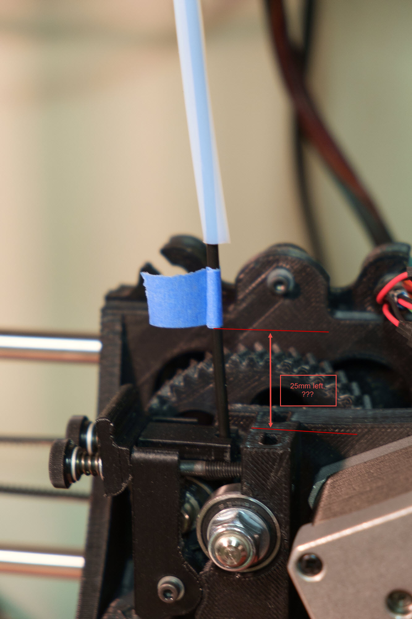

However just as a check, I put a piece of tape at 100mm above the flat part of the extruder, the stationary part, not the swinging arm, and did a 100mm extrude and ther was 25mm left! :open_mouth: WHAT?
Is it even possible that the extruder is slipping that much or that the extrude # is off in the firmware? I’m not sure where to look to correct this.
BTW, the little fan on the fins blows constantly.
I just checked the small herringbone gear to be sure it wasn’t slipping on the shaft, but it was tight, so that’s not it.
I can’t imagine that the steps are that far off.
That could be compounding on your problem. Make sure to clean the teeth of the hobbed gear and check that the filament isn’t binding on the spool. Make the changes to account for the extrusion difference and report back.

Thanks, I think I’m in the process of solving my issue. I tried to calibrate the extruder using the 100mm @ 100mm/m in pronterface, and found that not only was my esteps # way off, I inadvertently overtightened the hobbed bolt when I first took it apart for cleaning. :blush:
I’ve loosed that and the extruder seems to moving a lot more freely (Yeah, DUH).
