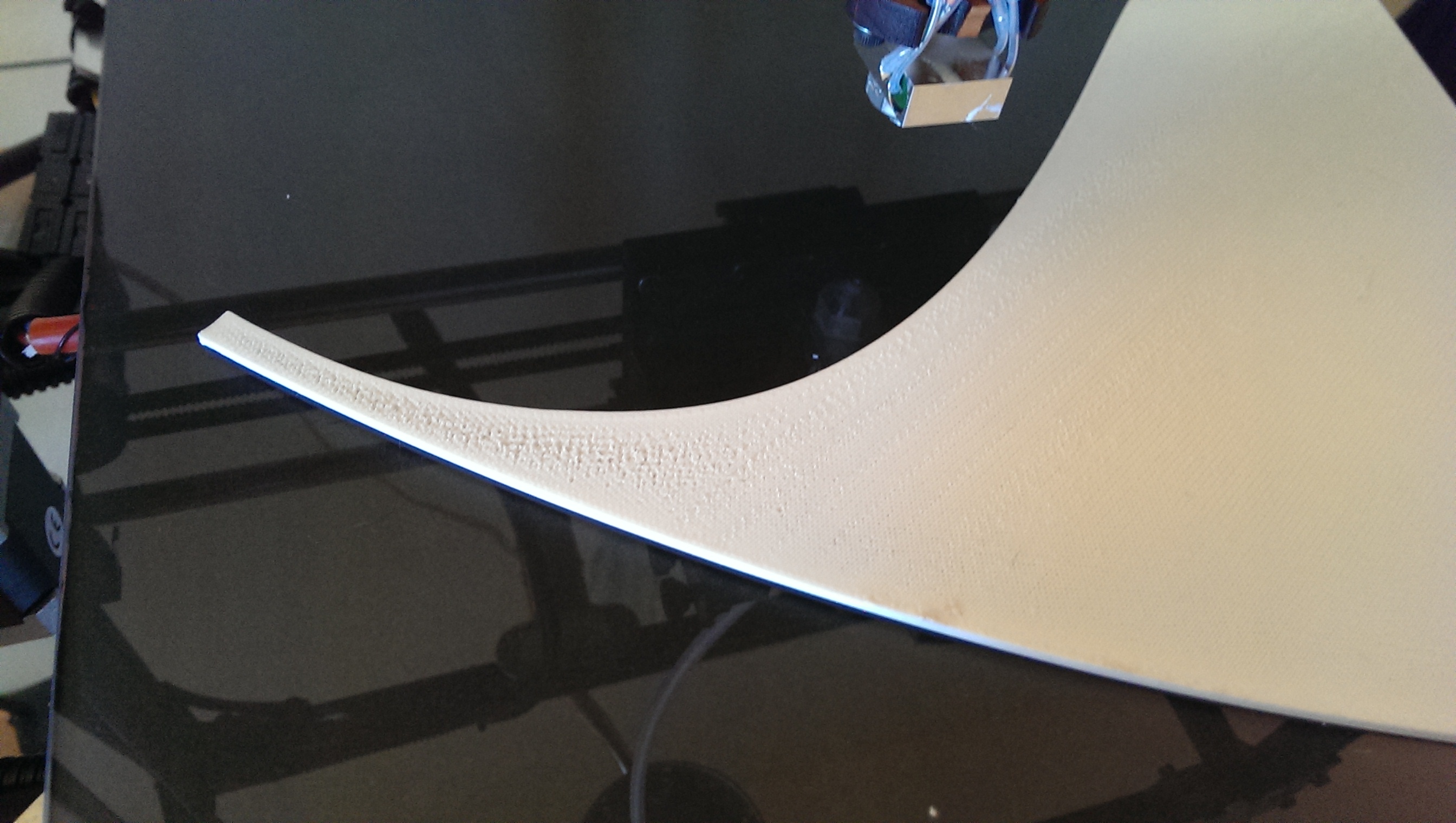

-I’m printing pla on bare glass cleaned with rubbing alcohol and set to 60c. When I print towards the edges I get medium to poor adhesion; guessing this is due to inconsistent heat bed.

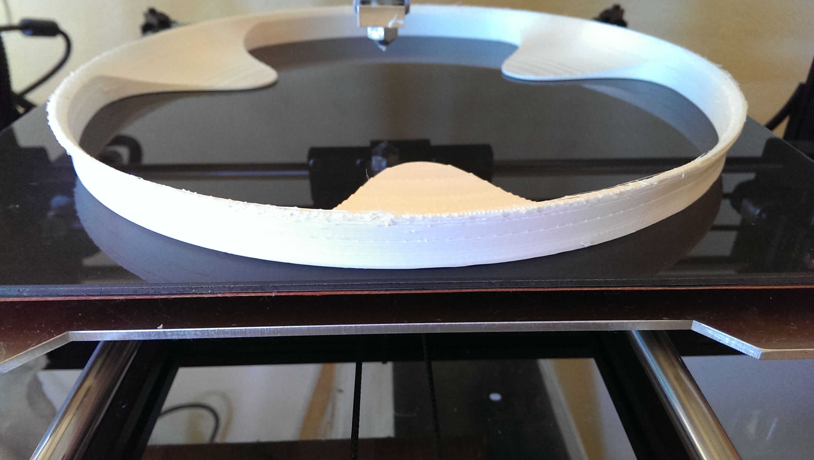

-using the draft and high quality settings the nozzle begins to clog and ruins the print
the warning signs begin with shorter movements that have missing lines, this then extends to areas with longer movements, followed by no extrusion. I’ve tried pausing the print to clean the hobbed bolt, but it quickly becomes clogged again. Initially, tightening the screws bought me more time but I still couldn’t make it through a print much bigger than an octopus.
also, as the print progresses the nozzle sometimes brushes the previous layer and drags.
I’ve read about pla expanding over course of a print so I tried turning the bed off after the first layer without success, also I’ve read about possible z step inaccuracies, but shouldn’t this be already calibrated by lulzbot? This is my first printer and expected a steep learning curve, however I did not expect so many hardware problems at this price point.

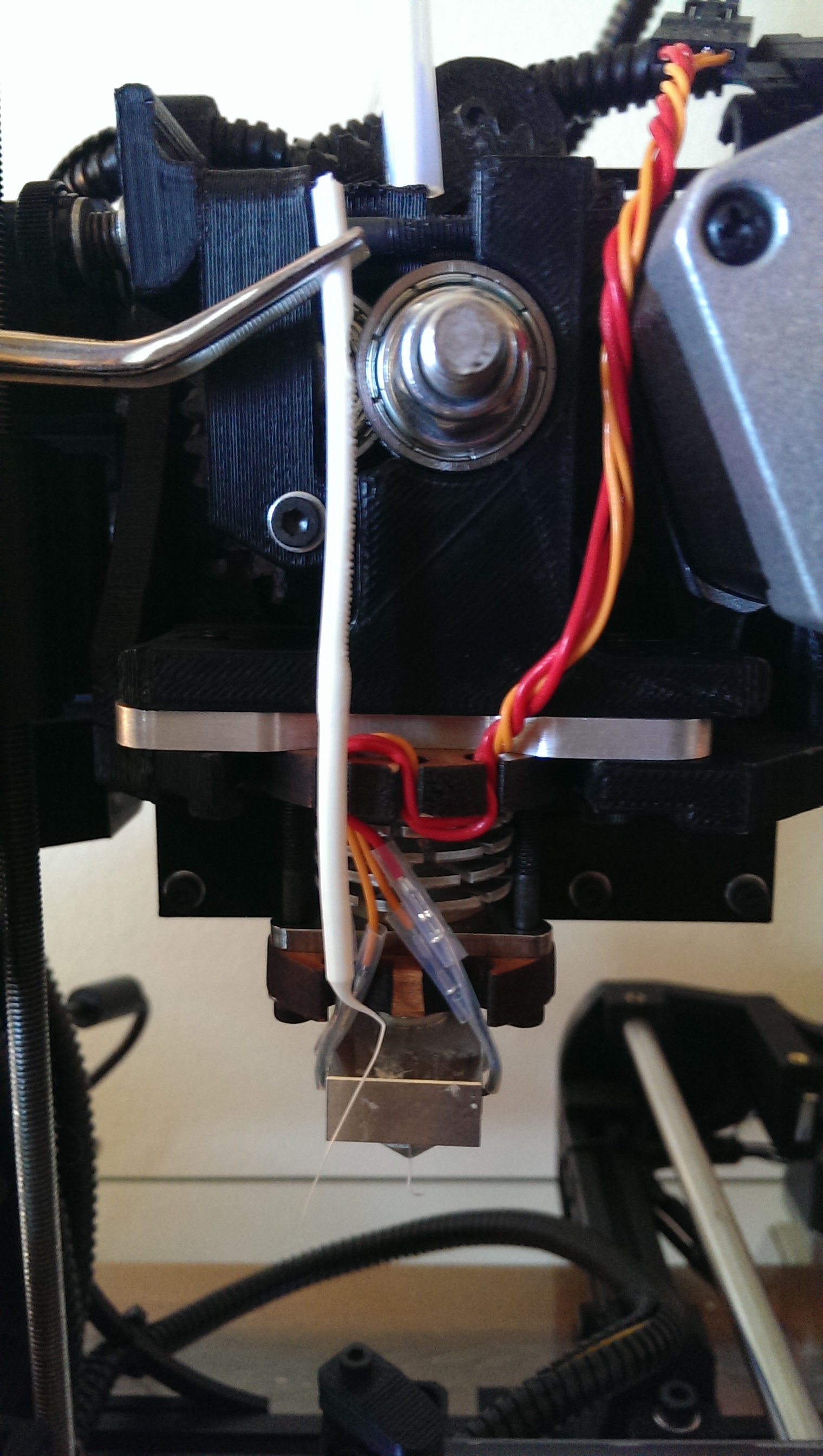

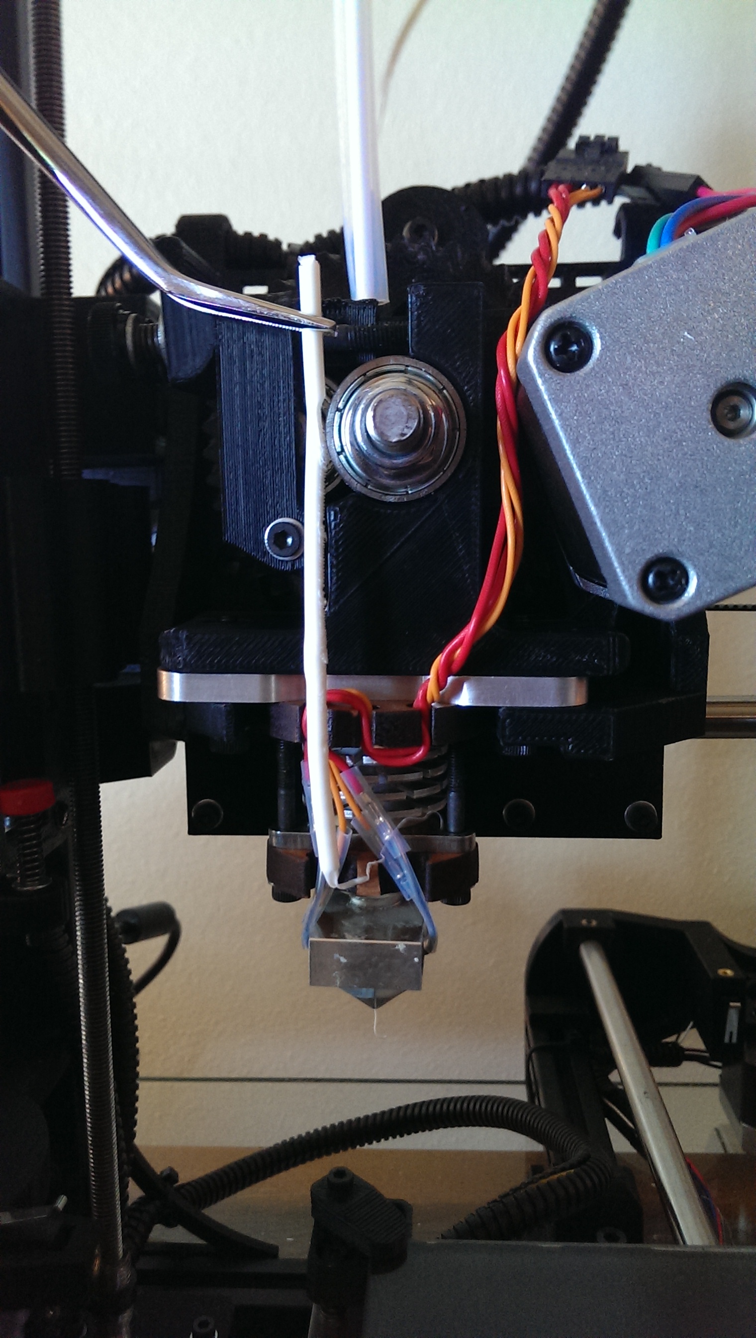

I dug through my trash collecting all my filament jams for further inspection, managed to find 6 of them. They all exhibited filament swelling well above the hot end where the filament would finally mushroom into a jam.
from top to bottom:
pre-jam filament measured 2.86-2.89
jam measured 3.18-3.47
swelled filament measured 3.00-3.20
There also appears to be a correlation between deeper teeth marks (higher tension on hobbed bolt) and thicker jams. I’m guessing that more bite on the filament was able to force thicker swollen filament through the hot end, buying more time. Of course, this also further heats up the extruder motor leading to the inevitable jam.
another thought; the jams are beginning in smaller areas with shorter movements because the high number of retractions are drawing heat and softer filament higher into the extruder where the jams occur. Also, the filament stays in the same place longer picking up heat. This is opposed to large perimeters, where a steady flow of cooler filament is drawn through the extruder, so my theory goes.

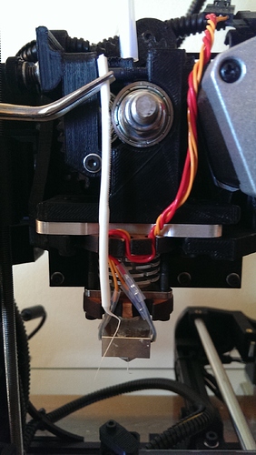

so, the attached pictures show that the pla jams are occurring immediately above the heat sink. I take this to mean that over the course of a longer print the sink can’t keep up with accumulated heat generated by the hot end and extruder motor.
One fan will be aimed at this juncture while trying to minimize air flow over the hot end.

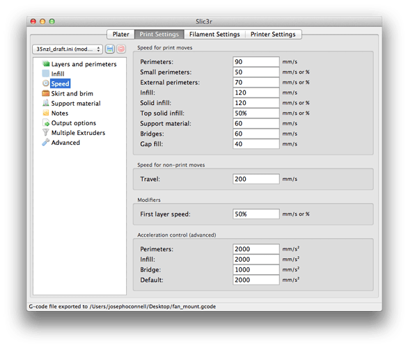

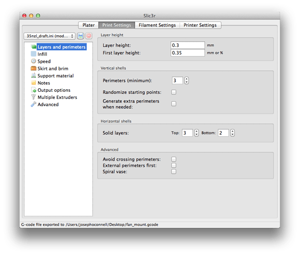

What speeds and layer thickness (and even width) are you printing at? all will affect how fast the filament is fed into the hot-end.
That’s a great idea! No problems with printing faster.
Though, at the current settings, standard draft config. provided by lulzbot, the machine can shake pretty violently during shorter movements. I would like to deploy the mods you made to improve rigidity and accuracy before going faster, but any suggestions you have would be welcome. I have started using the custom g-code you developed to limit travel speed.
Also, printing faster means that heat is getting dumped into the print, which has its own problems related to expansion on a larger print. Hopefully a fan on the print will remedy this and I can look at printing faster with pla.

Just wanted to bring resolution to this topic:
-filament jamming on 2+ hour prints was solved by mounting a fan directed at the heat sink. Prints of 7 and 18 hours have been completed without jamming. While a second fan was mounted and aimed at prints, this was kept off during my tests.
the heat sink fan is plugged into the extruder #2 fan slot and kept on for the entire print with the following gcode entered into the slicer gcode prefix:
M42 P6 S255
-the pla pooling on the heater block was solved by Teflon being applied to the threads ABOVE the heater block where the all thread connects to the heat sink. After twice using the lulzbot fixes and still experiencing pooling, taking apart the hot end revealed the source of the leak.
both of these problems and fixes point to the Buda 2.0 hotend having serious flaws with regard to heat creep and printing pla
