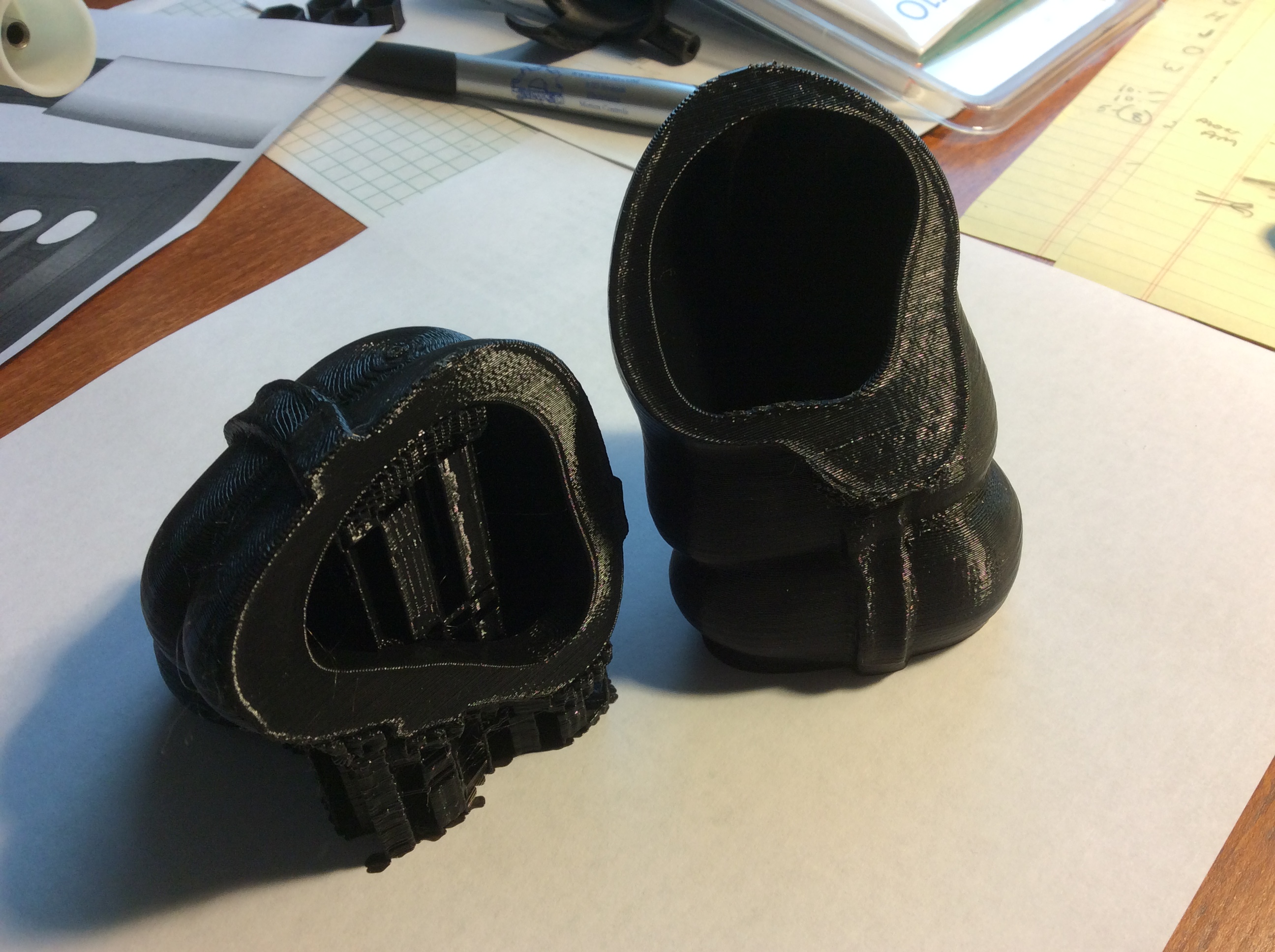

Well, I’ve posted all of my failures, it’s only fair that I post my SUCCESSES!
Last night I made a 3+ hour print - success! So I thought I would try another right after, so I started another and went to bed, and this morning another success, YEAH!
So far so good; I’ll build some more today and see what happens.

I think it was more that I was able to line up the extruder and the hotend together using a piece of straightened PLA as a guide. I may actually turn up a piece of Delrin to use as an alingment tool when reassembling the extruder after a tear-down. Just to have something that keeps everything in line while you tighten it all up.
Anyway, I printed another piece this morning and that printed fine as well.
So here’s hoping that my troubles are behind me.
THANK YOU - kc, mhackney, baltimorebully, piercet, wantmys2000, and all!

Yeah, this is working REALLY well now. After this mornings long (3+hours) print I have made two different multi-part prints and all is well in the land of TAZ!
Awesome!
Getf some extra nozzles so a clean one is on hand… I like the .5 nozzle since I generally print stuff that doesn’t need detail.
An update,
So I have printed several (maybe 8) different builds, some large 3+ hours, some small 20 minutes and some groups of small pieces.
All have been flawless.
So bottom line; IF you take apart your extruder/hotend make sure you REALINE it well using some sort of alinement tool.
