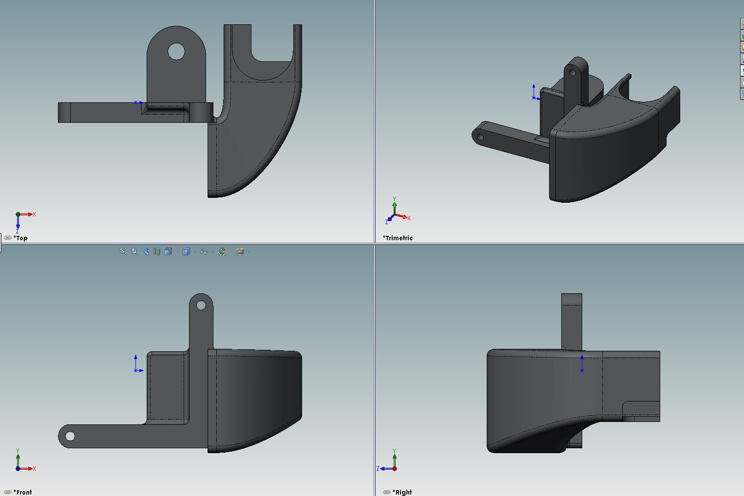

Which I can’t believe I haven’t seen with all of my looking around for answers. Anyway this guy JLC_Designs has EXACTLY the same problems I’ve experienced. So I am now in the process of designing and building a fan shroud based on a fan I got from a client for a job.
I’ll report back with files and links to the fan if and when this works.

So after I read that, I went and made this:
Not to re-invent the wheel, but because I had this fan laying around that I got from a client. (note to self: remind wife why I save all of this “crap”).
I printed this and then made some changes, so I’ll need to print it again, and if all is well, I’ll post it to Thingyverse and put a link here in this thread.

As promised. My fan shroud for the TAZ 5’s hexagon hot end.

I did notice the same temperature dipping thing happening with my version of the fan shroud. I put some tape over the inlet on the fan to lessen the air flow, and now my temps stay put. I was thinking about making a “swinging door” in my shroud to adjust air flow. The tape works but…not pretty.
I don’t know if you can see it or not, but the back side is 85% blocked off by the blue tape as well.
Hrm… To be honest, that was the reason I designed my shroud as I did - so I wouldn’t over-cool the hot end beyond its’ means to keep up. I wanted a good portion of the flow from the fan to go toward the feed assembly / hobbed bolt area. It looks like there’s a very fine balance to be had.
