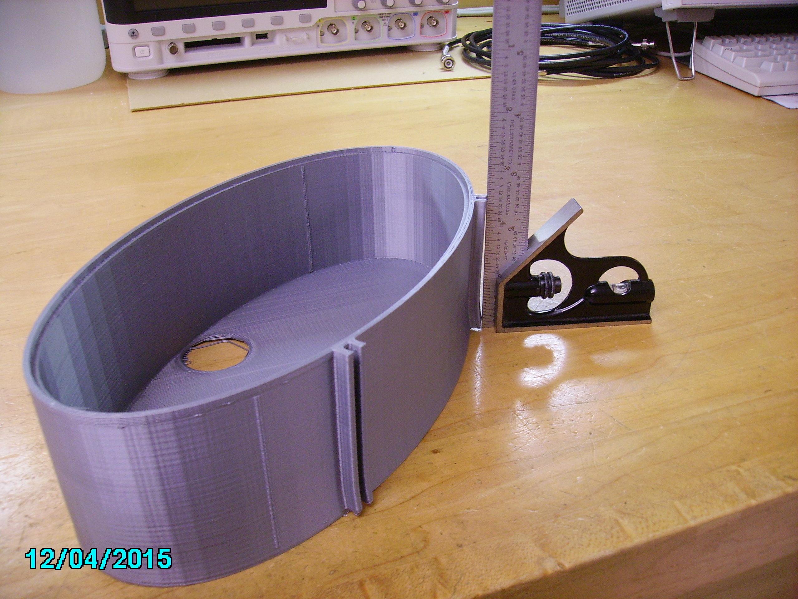

Warp of part along Z, answers?
Dear Lulzbot Forum Community,
I am getting warping in my part along Z. Please see attached pictures.
The settings I used are shown in the Cura picture. The file was saved to g-code and the part was printed on the TAZ 5 from the SD card.
Thanks in advance for your assistance,
Peter.
Which material and temperatures are you using?
Material is ABS, temperatures are shown in first CURA picture.
I would try to disable the fan, but there are more experienced ABS users here than me…
ABS tends to contract once above the radiant heat zone of the heated bed. You can try to add a second wall or bump up the infill to combat. Also, this is a specific case where an enclosure may help. You can try throwing a blanket / box over the printer (leave the electronics box outside and be sure nothing will interfere with the moving bits) and see if that helps.
Thank you for the suggestions. I thought about the heat zone above the bed, but I don’t understand why the part should again return to proper dimensions at the top of the part, which is also away from the heat source of the bed?
The lower part contracts during print. When it finished, there is no internal stress left, you are now printing the rest of the part on a “stiff” base, the rest of the part on top has not enough force to shrink itself and the already cooled down lower part.
Hope I expressed myself understandable :wink:
I have a similar problem, but I’m currently trying a different, almost opposite method to resolve the problem. The problem occurs on the lower layers of my part. The outer edge is also surrounded by a wall of support material working as an enclosing skirt. What I think is happening is that the lower layers are building up heat to a point that the plastic is still somewhat malleable, but cool enough to shrink. Being kept at a higher temp, and at the early part of the print, it has more time to continue to shrink as compared to the upper layers that are in cooler air and closer to the cooling after the print is complete.
I still need good bed adhesion, so I am printing the first couple of layers at 240/110. After 4 layers, I am dropping the nozzle temp to 235. After layer 6, I am dropping the bed temp to 100 and adding 40% fan to get the plastic to cool and hold it’s shape quickly. The print is about a 7 hour print and I am 1 hr in. I’ll post my results.
Also, my printer is in an enclosure and I am leaving the door open.
Scott
My test just finished. Mixed results. The warping was completely eliminated, but there are a couple of spots where there is some slight layer separation. I also found it much easier to remove the support material. I will do the next one with the nozzle temp at around 237. But in general, the outcome was far far superior than before. I do believe the issue is with the lower layers staying warm longer giving it more time to shrink.
Scott
