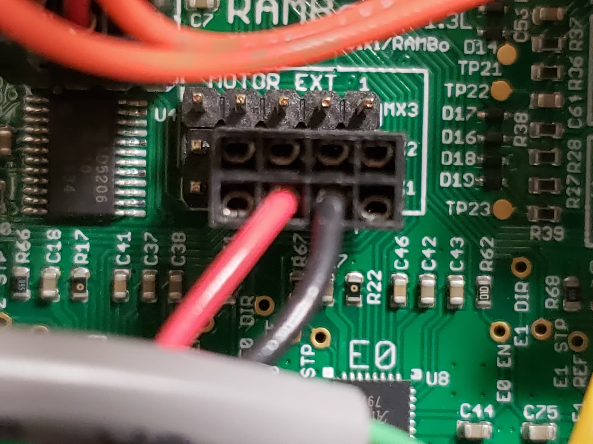

I recently had a blown Z axis on my Taz6. Based on this I replaced the board with a rambo1.4 kit. After replacing the board everything appeared to function properly. Though when I go to print the unit does not register contact with the washers. I have checked my wiring a couple times, but with the schematic on the board swap page I can’t identify which wire/connector is responsible for bed levelling.
Does anyone have any suggestions on how to address this?
