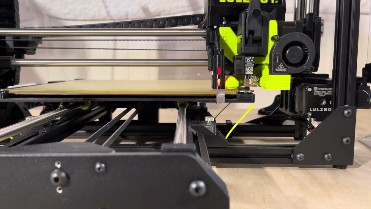

XT backlash calibration wipe off side?
I just updated the firmware so I could finish a print or two for my YouTube video.
This machine has the BL Touch and it’s the firmware for that.
The Backlash calibration is a bit wonky with the wipe off the ride side of the pad. Any idea why?

Still having issues with the wipe? Read on.
When you do the automated calibration, it’s just running a series of stored commands:
#define LULZBOT_CALIBRATION_SCRIPT “M117 Starting Auto-Calibration\nM104 S170 T0\nM104 S170 T1\nT0\nM218 T1 X44 Y0 Z0\nG28\nM109 R170 T0\nG12\nT1\nM109 R170 T1\nG12\nM117 Calibrating…\nG425\nM500\nM117 Calibration data saved”

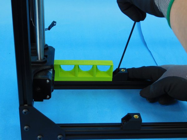

If you home the printer and just do a G12, does it behave the same way? Was it finding the pad just fine prior to the firmware update?
In order to rule out your bed being misaligned/assembled wrong like mine was, home the printer and validate these points line up to the pad.
#elif ANY(TAZPro, TAZProXT) && ANY(TOOLHEAD_Legacy_Universal, TOOLHEAD_Galaxy_Series)
#define NOZZLE_CLEAN_START_POINT { 300, 95, 0.5 }
#define NOZZLE_CLEAN_END_POINT { 300, 25, 0.5 }
Go to 300,95 and 300,25 and see if that’s the boundaries of the pad.
If it’s wildly off, you’ll need to print off some jigs and reorient the bed.

I mean, you can print off these two parts:
And validate they even assembled yours correctly:
And following steps 20 and 21 here:
Mine was pretty far off.

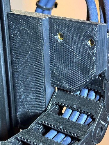

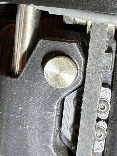

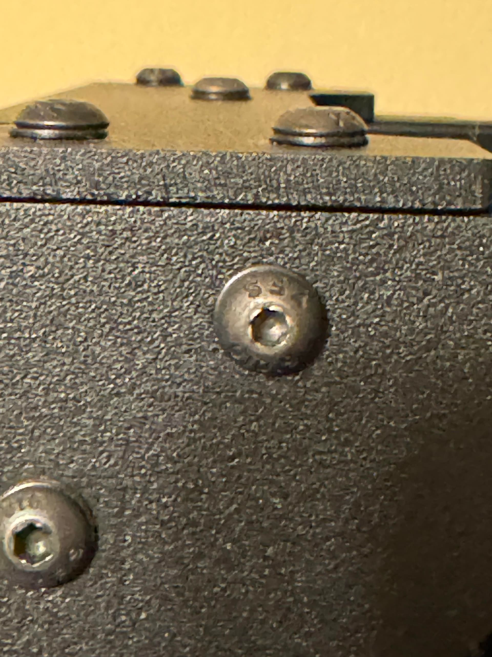

Okay so a customer needs to be aware of questionable firmware, not cutting edge slicer and now hardware that may not meet QC specs? Yikes.
Here is the build quality I received, for a printer costing me 6000 dollars.
Cracked x motor mount.
Questionable printed parts:
And stripped overtorqued screws.
