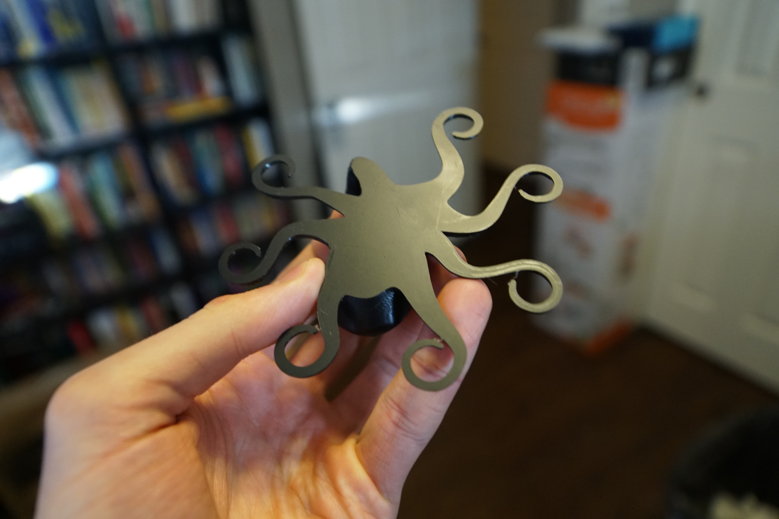

That being said, the best way I have found to calibrate my z-offset (which thank heavens I have gotten perfect) is to print a Rocktopus model (the one Lulzbot gives everyone, because it’s a valid, and clean model, and should print clean, with no weirdness). Upon completion pop that baby off the bed, check the bottom of the print. Is it a smooth sheet w/ no lines? if so, you are good, but if you can see lines, it’s too high, and you need to drop it down (I think you want to get a larger negative number if memory serves me right). See the image below for what a good first layer should look like. As someone put it, it’s almost “smooshed” on.

(Side note, I have literally 10-20 Rocktopus models doing this just laying around)
Wow! I have my work cut out on getting initial layers looking that clean.
