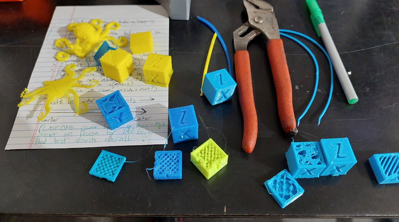

Some context: I’m a student at a state university, and we have a 3D print lab that I work in as one of the technicians. We primarily work with Prusa printers, but we recently came into possession of a TAZ 6 printer and we are very excited to use it. I’ve been tasked with setting it up properly so that students can use the printer for projects.
Background for the printer: it came from a group of four TAZ 6s from the Engineering school, where they “rarely” used it, and most likely printed in ABS.
We only use PLA due to its relative safety within a ventilated area that gets populated with student projects often. I flashed the newest update of the firmware to the system and loaded up some 2.85mm PLA filament that my professor provided to me. He did tell me that the PLA he had in that size was a bit off-kilter (it had been sitting in a bin for a while) but I still gave it my best shot.
We began having issues right away. The first and foremost issue was, as predicted, the filament–it was definitely moisture-damaged, so I chalked up a lot of “blobbing”, dragging, and stringing to that. This was also from me using the default TAZ 6 profile on Cura (which I hadn’t used before).
My next idea was to try using our ample 1.75mm PLA filament, which we use with our Prusas, and I double checked to make sure that it would be okay in the TAZ (sounded like yes, so long as the gcode settings were correct). But even still, we run into issues–there seems to be a problem with the infill (gets streaky) and with layering (there are often gaps).
I’ve tested just about everything I can think of–I tried different presets in PrusaSlicer for the TAZ 6, I’ve tried cold/atomic pulls, I’ve tried calibrating the z-offset and e-steps about a dozen times, and yet we keep running into problems.
I don’t want to throw in the towel, but my knowledge only goes so far. I’d like to turn to the community for some help. Any suggestions are appreciated. Considering we essentially received it for free, we’re not terribly keen on replacing a bunch of parts, but if something like the nozzle or the abrasive pad can be swapped out, we’ll do that.
Thank you all for taking the time to read and help me out. We appreciate it!

Hi everyone, thanks for all the suggestions and replies :smiley: I’ve come back to the lab today with a fresh roll of PolyTerra 2.85mm PLA filament.
I tried printing right off the bat, got some poor results. Then I decided to re-calibrate E-steps, and they were off, so I fixed that up as best as I could.
I’m also trying out some custom gcode to skip the wiping process (which has been a little problematic) and instead extrude out a purge line at the bottom of the print bed, since I noticed that prints would often fail to extrude the brim and would start printing somewhere in the middle of the initial layer. (A clog? Bad E-steps? Stripped extrusion screw?)
I’m only scared that if having fresh filament and re-calibrated E-steps doesn’t solve the problems, that the issues are internal, and I’ll have to disassemble the hotend assembly.
By the way, this is what the filament looks like after another cold/atomic pull. It looks very… “bitey” if that makes any sense? Like the gears really dug into it, more than usual. But maybe this is normal–correct me if not.

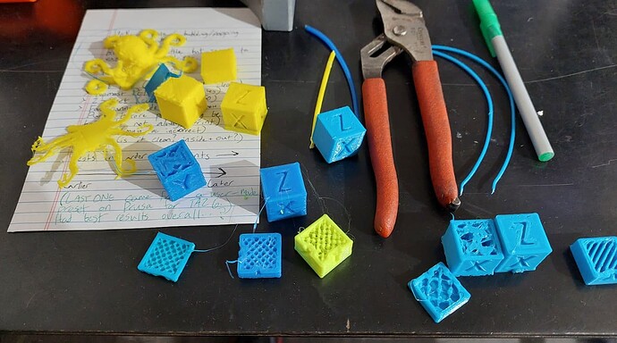

Most recent results after trying the custom wiping… Ouch!
I’ve had better and worse… It’s almost like it’s not extruding enough in its passes, or gaps are being created in the filament as it extrudes.
I think I’m really lost for ideas at this point. I’ve cut its speed in half, fiddled with flow, tried dialing in the temperature, even used custom gcode…! I’m going to try printing one last cube tonight, and then it’ll be left until Friday, when I’ll try to work on it again. (I’m feeling a bit more hopeful as the one being printed right now seems to have a smoother-looking outside, but it also looks like it’s getting a little squashed.)
Again, thank you all so much for the help and suggestions… I’m still learning about this machine and I consider it a great learning opportunity (if really frustrating at times!) to be working on this TAZ 6.

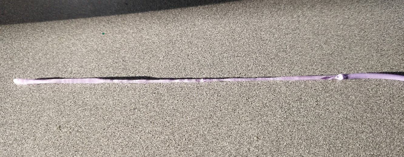

Interesting development… I don’t know how this happened, why it happened, or how to fix it.
I shut off the printer for the evening, and decided to poke around at the toolhead. I pulled out the filament and… it seems to have gotten stretched within the extruder so super-thin that it actually became hollow in the middle. I’m baffled. Really.
Is the hobbed bolt full of filament on one side, so you’re only extruding for like 66% of the time?
