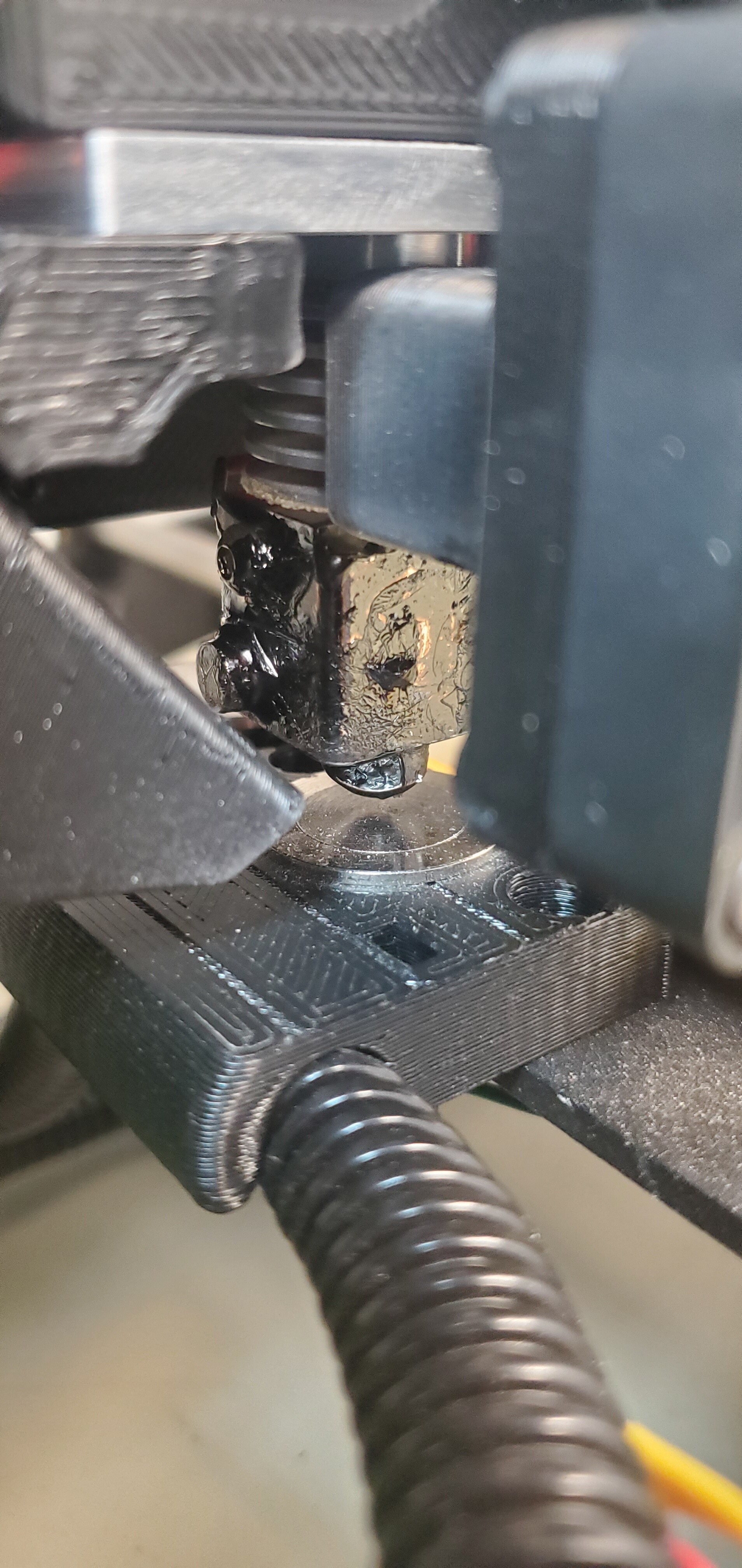

Just updated firmware and the toolhead crashes when trying to autohome. The nozzle touches down on the housing of the Z limit switch when homing the z.
Also unfortunately, the toolhead moves in the x and y on startup further crashing the already crashed toolhead, which has created some play in the toolhead carriage.

I’ve narrowed the issue to one toolhead. It seems that the nozzle on this toolhead is in a different position compared to different toolheads (all standard .5mm toolheads). This didn’t cause an issue on old firmwares because it seems that the “y” position when zeroing was closer to the center of the z limit switch.
On the new and old firmware the positions when autohoming are X -19 Y258 Z3. The Y on the newer firmware seems to be ~5mm closer to the edge of the limit switch (towards wipe pads). Is the (0,0) on the new firmware different? I’ve flashed .5mm toolhead firmware and selected it on the printer too.
I am talking about version 2.0.6.5 and 1.1.9.34.
Photos attached of where the x and y zero to while both returning the same coordinate, ignore the dirty hotend, had a print detach.
It might be worth moving the y axis in the corresponding direction so that it hits more in the center.
