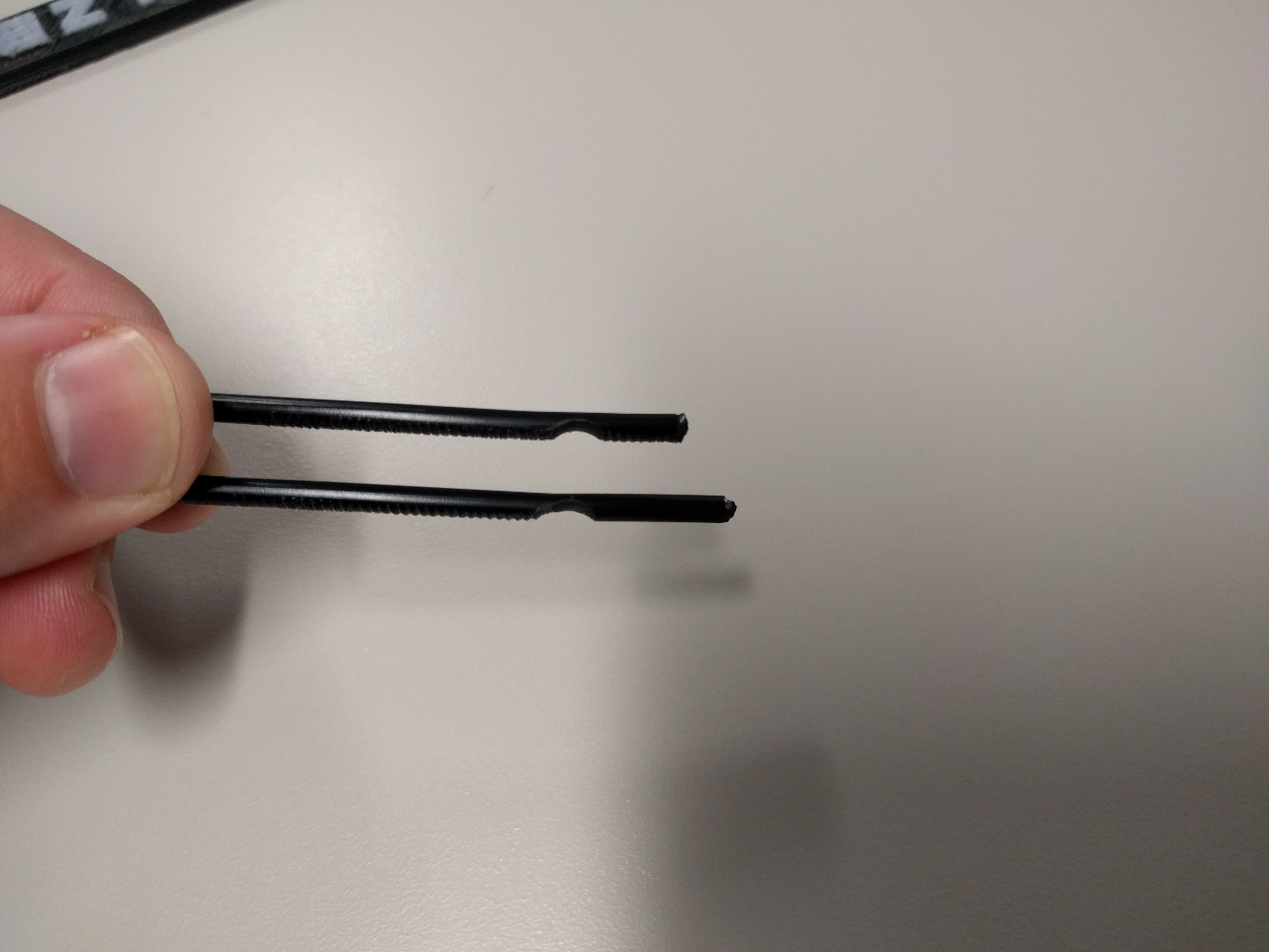

I am trying to set up the dual head extruder. I went through all of the steps on the Lulzbot website, but I am having some issues. Early on in a print, when the T0 (rear) head tries to print, the filament lowers back into the head, but it does not extrude. The drive gear is spinning, and cutting a divet out of the material, but it will not push it through the head. If I pause the print, lift the extruder in the z, and manually extrude, then it works, but as soon as I return to printing it will not work. Sometimes I have to pull the material out, and cut off the end above the divet cut by the drive gear, but when I reinstall the material it extrudes fine when it is up in the air. After 1 or 2 skipped layers by the T0 extruder it will start to print, but the quality is lacking. The T1 (front) extruder is working a little, but it is printing a very wide and squished out line and looks pretty terrible.

Attached are pictures of the filament with a chunk missing from the drive gear, and the Lulzbot keychain print, which looks terrible. On the keychain the black material is out of the T0 (rear) extruder and is ABS, the white material is HIPS and is out of the T1 (front) extruder. Head temps were 240c and bed temp was 110c. We went with standard settings, we havent messed with the advanced stuff yet.

Have you tried extruding filament with both while the toolhead is raised above the bed? If that works then, you’re probably correct that the auto-level procedure isn’t working properly.

I just ran another print, but this time only using the T0 head, and it printed just as well as the single head extruder. It skipped the first three layers, but after that it was no longer pressed into the bed, and the quality was great, whereas with both heads printing the quality was terrible for both of the heads.

Ok, so I found the Z offset option in the printer menu under Configuration -> Advanced Settings -> Z Offset.
I opened it up and it was set at -1.500 by default.
So I adjusted it to -1.000 and will do a test print and adjust accordingly.
Edit: The print is going pretty well, I think the issue is fixed!
