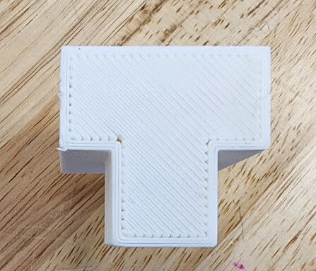

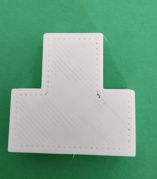

The white print is PLA on my Lulzbot red arrow shows holes on the top. This is with five layers on top and bottom.
The yellow arrow is another hole, it isn’t wall delamination.
The blue arrow is a little bit of debris on the lower corners.

The white filament is completely blown out in the image, so almost impossible to see any detail on the surface quality. Try the photo again with a white background, or another color of filament.
Why are you using that extrusion modifier? An extrusion modifier of .9 basically means you’re 10% underextruded, which would easily account for those gaps you’re seeing.
In almost all cases, your extrusion multiplier should be one of the final fine-tuning calibration steps, and .9 is fairly significant.

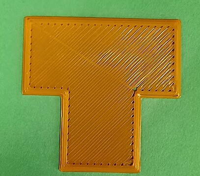

This is the bottom of a single layer print
.23 Z offset 40mm/sec (I’d turned this down from 60mm/sec when I started this).

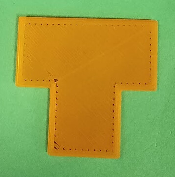

This is the top
Did your extrusion multiplier get put back down?
It looks like it’s still underextruding, but squished enough to compensate on the straight lines.

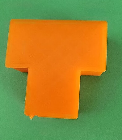

Here’s the bottom using Cura. That looks pretty good to me. There is some elephant foot on there.

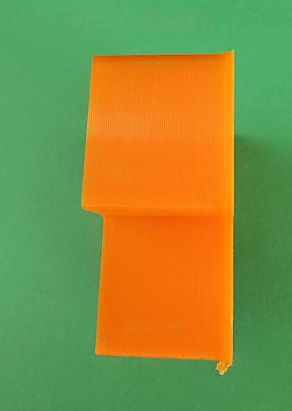

This is the side, layering looks good.
Now I’ll play with speeds in Cura and see if I can sharpen up the corners. Would new belts help that?
Strange that the software I’ve used for five years suddenly produces bad prints, happy that the printer won’t need a whole lot of work to keep on going!
Elephant’s foot is the result of the nozzle being closer to compensate for the flow that you had been doing before. With proper flow, the offset can be set to what it should be now.
For sharpening the corners, do a pressure advance calibration. With that dialed in, the only thing that will sharpen corners with molten plastic is a smaller nozzle.
