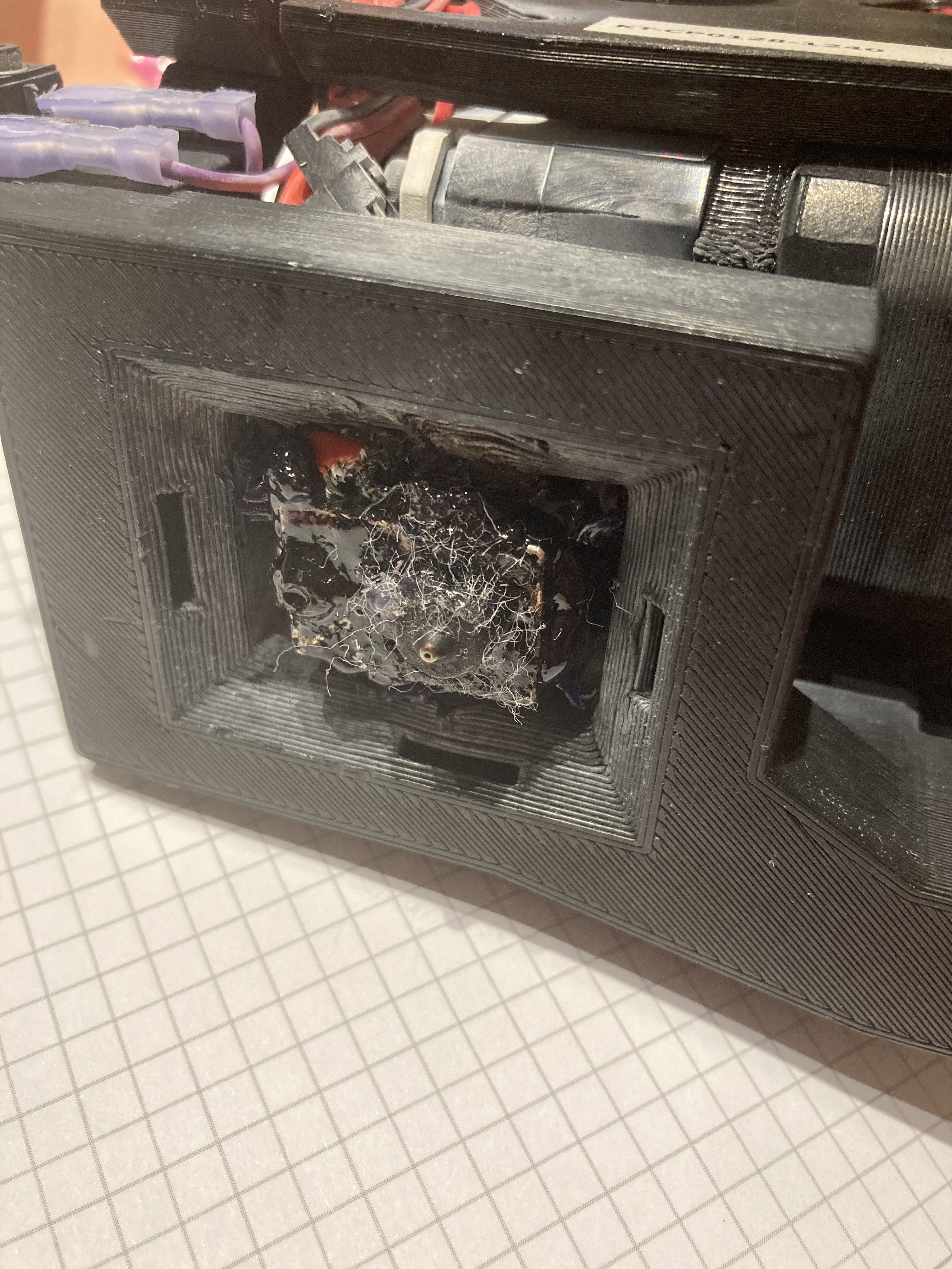

That’s the bottom of the hot end. What’s the best way to clean that up?
Disconnect the toolhead from the gantry, but leave it connected to the harness. Set it on it’s side (like in the picture there) and on something that can hold it steady. You want it in a position that is very accessible and comfortable for you to work on it.
Get some wooden toothpicks or popsicle sticks (nothing metal!) and set the hot end temp to about 160 (assuming it’s PLA on there).
Then just relax and work it off, bit by bit. Be very careful around the heater and thermistor wires. If you break either one, you’ll be stuck using a heat gun and there’s a decent chance of breaking wires or melting plastic bits of the toolhead.
I removed quite a bit with toothpicks and some needle nose pliers once I was able to get some out with the toothpick.(pliers not neat metal) I don’t know what that filament was but I had to go to 210 just for it to soften up enough for the toothpick to move it and not break. I might dissemble it tomorrow and use a heat gun, the toothpicks could only do so much before they broke. Would it be possible to soak it in anything like acetone (don’t know if acetone would break down whatever is on it)
Don’t use acetone around the plastic of the toolhead, but if you can get the hot end off, you should be fine to give it a try.
