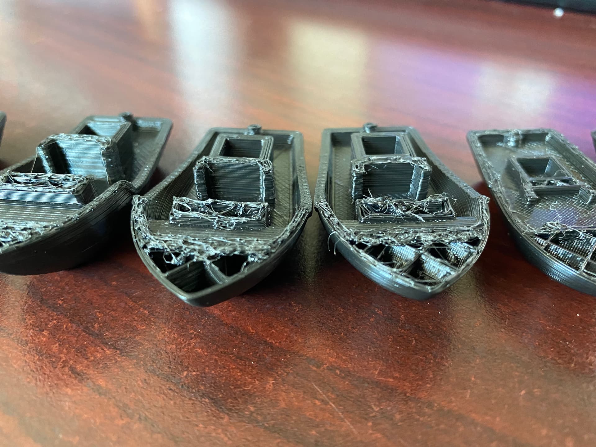

I have a new lulzbot mini 2 and it’s keeps failing half way through prints no matter what I attempt to print. When it fails the top of the print appears very hair if that makes sense. Please help I’m willing to try anything.

I am attempting to print a benchie right now it gets half way through then starts making webs is the best way to describe it. It estimated the print to take an hour and fails at 30 minutes every time. I am printing and the default temp of 205C. I apologize for the vague details earlier and will try to be more descriptive of the problem

Benchy’s layers look a little inconsistent. Did your printer’s feed rate get set above 100%?
No it didn’t. I’m really stuck here and haven’t found a solution yet just tweaking temperature and print speed now with little results. I have one almost finished benchie with about twenty or so fails
Don’t know if this helps but here is a closer look at the dots
