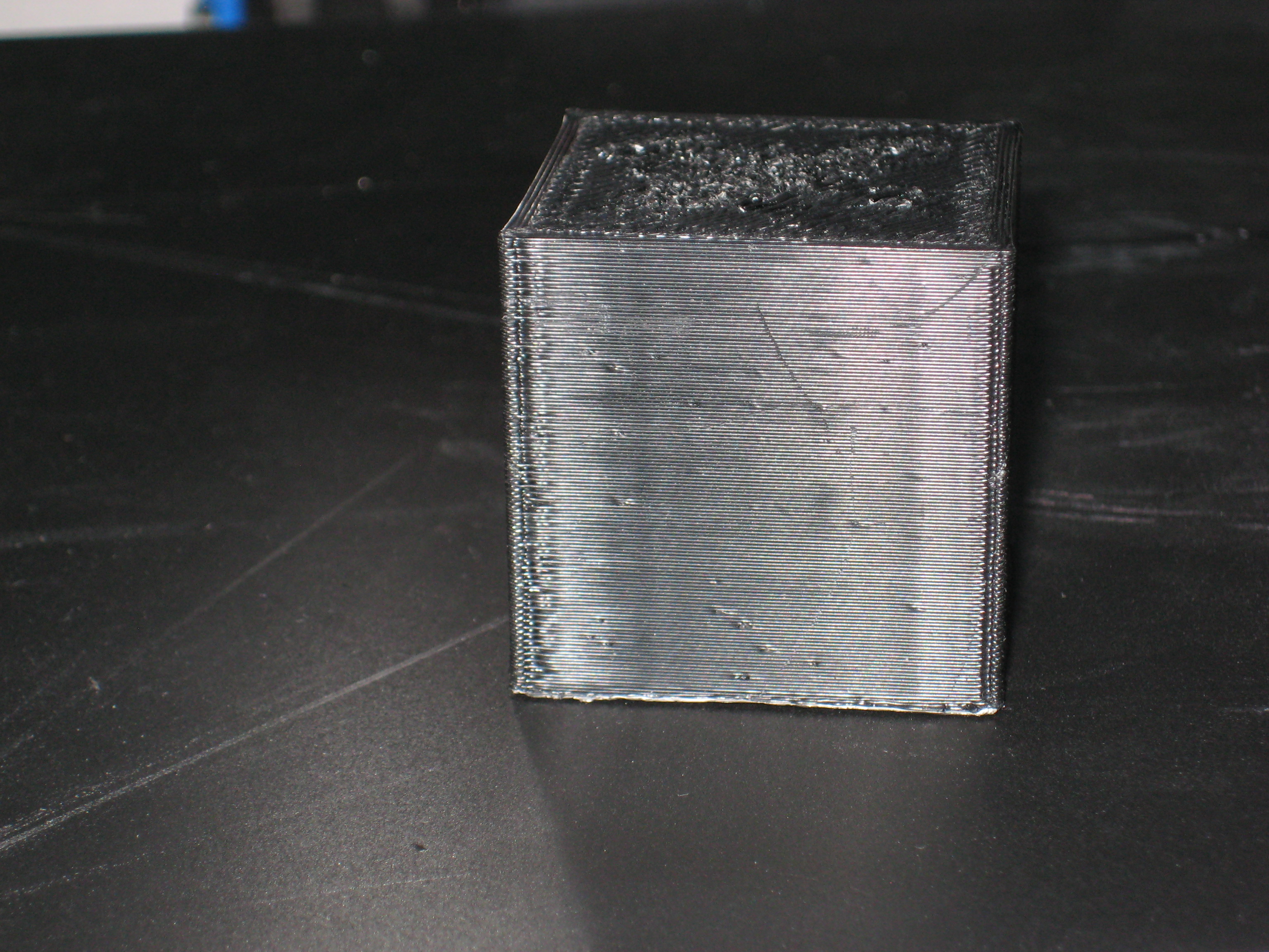

Anyone want to know about how fast my modified taz can print things at? Me too. It turns out, if my math is right, it can go at least 400mm/s, faster if I figure out how to make it go faster than that.
Anyways, here’s a long boring video showing it printing really fast

Cube pictures:
bottom:

How accurate were the dimensions at that astonishing speed?
I actually ended up 0.1mm under on all sides after it cooled down except top to bottom, which was dead on at 40.00 on the second higher spoeed one. The first one was 0.2 over on all sides except the top which was .05 over. Normal speed prints I usually end up at 40.00 on all sides. definitly some extruder oddness at the higher speeds though.
What was your acceleration for the first 400mm/s video? On a 40mm cube, you need at last 4000mm/s² to reach 400mm/s at least on the middle of the perimeters.
Anyway, you prints are looking amazing and the speed is incredible :sunglasses:
first video was 3000 mm/s^2. Second one was 6000 mm/s^2

As far as I can see on your pictures, your cube shows no signs of ringing even at 3000mm/s² in your 400mm/s test? Do you have some other examples of higher speed prints where we can see top surface and sharp edges quality?
Which of your mods (X,Y,Z) bumped the quality the most, would it be OK to stay with the rods on the Z axis?
My biggest concerns are about the heat inserts. While I found some shops that have a small selection of Openrail profiles, I found not a single one where I can get heat inserts :confused: Hopefuly I can modify most of your parts to be used with normal nuts in some way…
I haven’t printed many things at that extremely high print speed because I didn’t want to put very much wear and tear on the machine. If you would like to see a specific part printed at high speed, let me know and I can print it. At the higher speed pass on the cube, I was under extruding a bit because the hot end couldn’t keep up, but there was no ringing or wobble present at all even at that speed.
