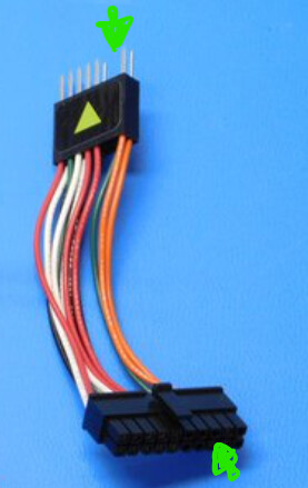

From your description, the zero sense wire for the new toolhead isn’t connected right. The center disc it presses first is a switch, so no connection goes through the toolhead. The washers use a simple circuit going from the washers, through the toolhead, and back to the circuit board to determine when contact happens.
Since the old toolhead was working (I assume) the connection from the harness to the circuit board should be good, so I’d start checking for continuity between the nozzle and the zero sense wire connector here:
To the harness pin for zero sense where it plugs into the universal harness adapter:
And then follow that wire to check check for the connection between the universal harness to the Taz 6 toolhead harness. (arrows may not be pointing at the exact pins, just follow the zero sense wire)

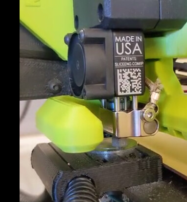

Here is the image of the nozzle after I stopped the failed zeroing attempt during the print.
https://drive.google.com/file/d/15K1g9Aftk39mj6Yh76_XxiPy7StDRqLl/view?usp=sharing
I just purchased the head from Lulzbot a few days ago. The box has v2 on it and the fan shroud has v2 engraved into it.
Is it not the v2?
It’s definitely a V2.
Videos definitely helped. Usually when you refer to the washers in leveling/homing you’re talking about these washers, not the rim around the button.
This is not centered on the button very well, from this angle it looks like it’s too far forward:
And it’s even more forward in your homing sequence.

Then attempt to auto-home again. If the button press is not centered, then your Y axis is not in the proper position. Loosen the thumbscrews that hold it in place, then pull the entire Y axis (not just the bed) FORWARD about 6mm and tighten them back down.

Your startup appears clean for offsets, so it looks like it’s a physical misalignment. It would be best to confirm squareness of the frame when you move the Y axis forward to compensate.
It’s likely somebody else moved the Y axis already to try and compensate for mismatched firmware settings, which is why it’s off right now, but if it got knocked when being moved, it won’t hurt to verify that everything’s square.
Thanks for all of the help. Moving the y-axis up did the trick, though I did have to unscrew the allen wrench set screws instead of using the hand twist screws.
