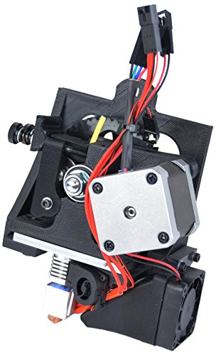

I was cleaning the extruder with the wire brush (see picture) while it was heated up and there was a spark and a pop and the machine died. Plugged a different functional power supply into it and it does not power on.
You at a minimum killed one or more fuses. You may also have killed either the thermistor or the heater core. There are fuses in the following locations:
a. Large fuse in the electronics enclosure
b. 2 small grain of rice sized fuses in the electronics enclosure (be very very very careful removing these. If you accidentally get one of the metal fuse contact plates and yank it out of the board, it is expensive…)
C. There may or may not be a larger fuse in the power supply at the plug location. I can’t remember if the TAZ has one there or not.
Replace all of those fuses. if it still doesn’t power on at all, you could have a toasted Rambo board, which can be sourced from either lulzbot or ultimachine if you want the exact same stock board. The machine should still power on even if the thermistor or heater core are toast.
It will most likely be your F3 fuse, as nothing will turn on. If you don’t have access to a multimeter to check for continuity (ohms), you can swap the F2 and F3 fuse to verify. This will allow the printer to turn on, but will not allow motor movement. If the fuse is blown, you can find replacements here: http://www.mouser.com/ProductDetail/Littelfuse/0448005MR/?qs=zLq6hPBL7g7rOZQEM1wS4Q==
Do you by chance carry your TAZ around using those wires as a handle? From that photo it looks like 2 of the 4 have the conductor exposed, and one is completely disconnected? I would also suggest replacing the hotend / fixing those connections PRIOR to attempting to restart the machine. This is not a Lulzbot branded Hotend but it should be the same
Fuses came in the mail, and they fixed the problem. Runs like a charm.
