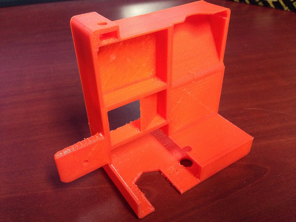

TAZ 5 80mm Fan Shroud -- Files linked
I was able to successfully print this mod and add it to my hexagon hotend.
It’s working great so far. I printed a 9hr print using PLA. This was my first ‘long’ PLA print in a LONG time!
Thanks for this!
-Adam
