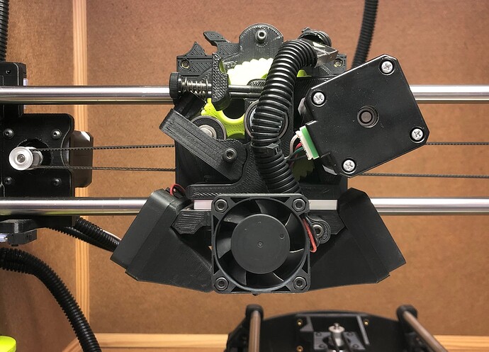

Hi, I just bought a second hand Lulzbot taz 6 printer, it is setted for 2.85 filament and has mounted a 0.5 mm nozzle what I have to do if I want to print with an higher diameter nozzle upon 1.2mm let’s say 2mm? Any suggestion?

Thanks Zenotec thanks for your answer. Do you know what tool head mount the TAZ 6? In the photo attached the machine I am getting, could you tell what tool head is on? If you recognize it do you think I can use the 1.8mm bondtech nozzle? Otherwise I will follow your suggestion and I will buy the SE tool head.

This is likely a modified Taz 6 Single Extruder (not to be confused with the SE). Without seeing the hot end, it’s not possible to know if it’s the Single Extruder or the Moarstruder (or possibly a hot-end swap to a V6 or something else). This toolhead has modifications - visibly a larger heatbreak fan, and a heatsink on the extruder motor. If there are other modifications, we can’t see them - but the factory parts (except for the gear) were printed in black from the factory, not in the green seen here, so this could be almost entirely a custom unit, or just a reprint.
Another notable change is the print bed swapped from a PEI sheet on glass to a powdercoated spring steel surface.
The Single Extruder was designed around printing ABS, so part cooling is pretty bad if you plan on doing PLA, and what part cooling there is is poorly aimed, which can, as zenotek said, cool the nozzle, causing inconsistent extrusion at best, or the printing erroring out due to the inability to keep temperature.
If you don’t have a supply of 2.85mm filament sitting around, I’d recommend skipping the SE toolhead and go with a high-flow 1.75mm toolhead instead. M175v2 if you want something off the shelf, or a self-built Orbiter + Phaetus UHF type unit would be great.
