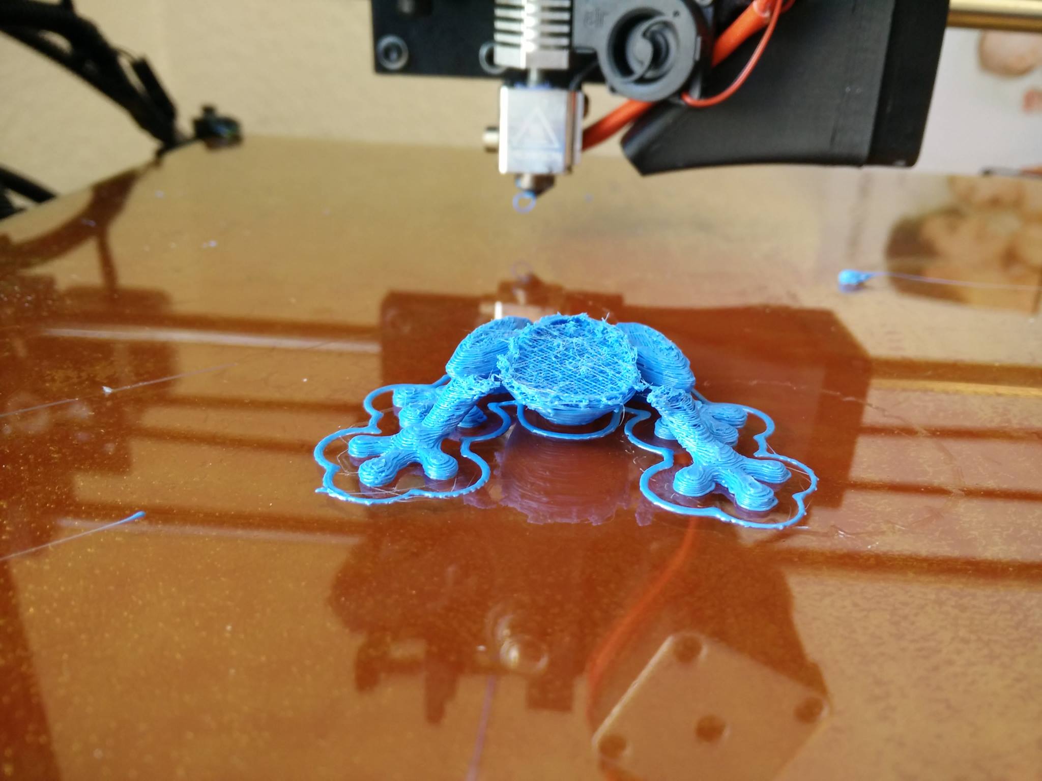

exactly the same problem here - got the new hotend/extruder for my taz 4.1 (thanks lulzbot! great customer service!!) and everything worked out fine in the beginning with short prints.
with longer prints, while the little fan is running (and making some noise), first hour turns out great, after that the extruding slows down, the hobbled bolt eats into the filament, extruding stops.
i always found a “drop” of filament at the nozzle-tip afterwards, if this is any indication for anything.
as it seems this is a hotend cooling problem, are there any suggestions to increase the quality/amount of cooling the hexagon?
Check the polarity of of your fan connection. If it’s running but not cooling it most likely is running backwards. It could also be a possibility that–because the connections are the same–that the filament fan and the nozzle cooling fan are switched around. A quick check of that is to see if the filament fan is always running.
Easy way to check if the squirrel fan is operating properly is to pull a hair from your head and, while the machine is powered up, see if the squirrel fan will suck the hair in toward the housing. It’s a really small fan so you may want to take it off and make sure that there is nothing obstructing the fan.
Also note that higher extrusion temps are needed for the new hexagon hot end… try +5-10C.
Fan is blowing inwards, the heatsink never got really hot (could touch it without any problem, max. 30°C i’d guess).
Nontheless the print jammed at 8.3mm height (layer height .21, 210°C), nozzle clogged.
The filament shows marks from the hobbed bolt and after cooling down and removing i noticed, that the front portion of the filament was molten to little bit thicker round shape - so i suppose the tube got hot nontheless - or is that normal?!
filament is a little undersized, 2.7mm diameter. But had the same problem with 2.85 material.

As for RiceCakes photos, my issue is different. It is an immediate stoppage then chewing through one spot.
It would have chewed out the filament if i hadn’t quit the print.
Nontheless my prints don’t stop suddenly, it’s more like fading out the percentage of extruded filament.
any suggestions what to try?
@RiceCake
The filament tip being melted is normal–and a good thing. The only thing I can think of, right now, is that the z axis is off and it’s creating excess back pressure in the nozzle. Check this thread out, hopefully it can help you out. https://forum.lulzbot.com/t/new-user-calibration-cube-issues/1521/1
Try printing something that is big and flat to rule out that it has to do with the print reaching a certain height. In your photo it seems like the print goes bad long before the filament finally strips out. Do you have any other types of plastic on you? Try a different material.

I tried PLA from an different source, which at least did not quit the job but didn’t turn out totally pretty as well, especially in the first half… the frog worked perfectly fine with the budaschnozzle before updating.
any suggestions for a) getting the blue filament to work b) what to do about the “thin” layers in the green print?
For A) seasoning the nozzle seems to be a technique that is often used to get PLA to run through a nozzle better.
For B) try slowing down the volume of PLA that you are trying to push through the nozzle. Either print slower or shorten up your layer height.
